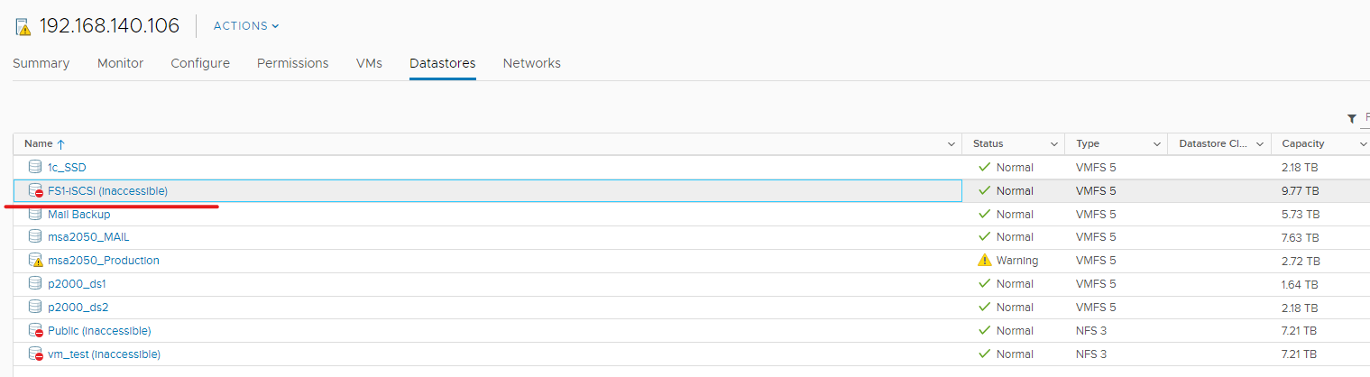

    Three esxi v6.0.0 servers had iSCSI configured on a Synology NAS server that went down. We bought a new NAS server, fixed the old one and migrated the LUN from the old one to the new one. After trying to connect one of the esxi hosts found that the current iSCSI Software Adapter on it contains information about the old connection. I deleted the previous connection in Static Discovery and created a new one by Dynamic Discovery. Under Devices and Path I could not delete the entry, it is frozen:

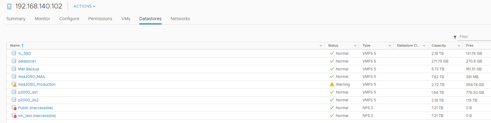

    However, I decided to connect the esxi host to the restored LUN. I added it via Discovery, then clicked Rescan Adapter, then Rescan Storage. On the NAS server, I saw an iSCSI connection. But the problem is that I didn't see the previous configured array that should have appeared in the Datastores section of the esxi host after this procedure. It's gone. Why is that? It seems that ESXi considers it as a new device. How do I get back an FS1-iSCSI named store that was previously attached to an old LUN?
    But it is still configured and in an Inaccessible state on the other two esxi hosts.

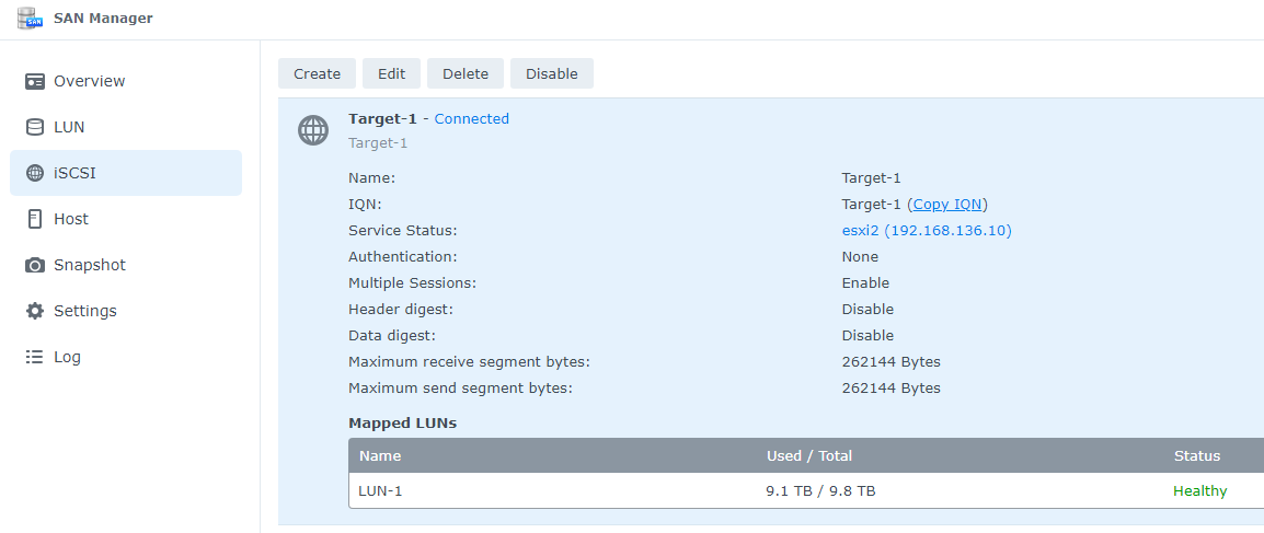

    Screenshot from SAN Manager of Synology NAS (LUN-1 was backuped by Hyper Backup package on Synology and recovered by Hyper Backup Vault):

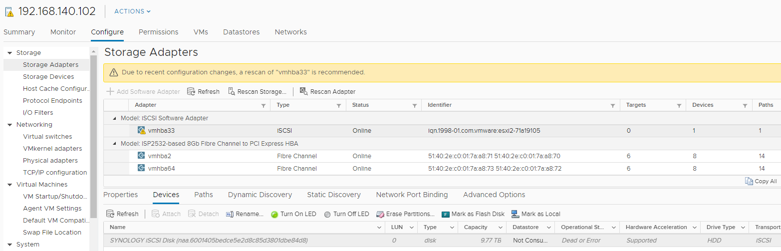

    Another screenshots of 192.168.140.102 esxi host:
    Devices:
    Path:
    Dynamic Discovery:
    Static Discovery:
