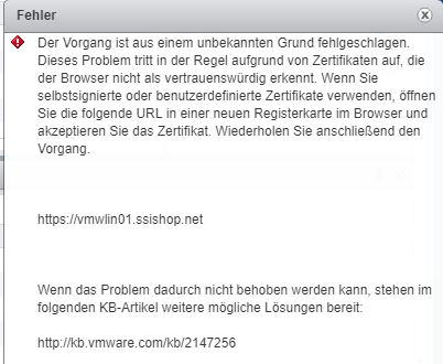

    i use vSphere 6.7 and i try to upload an ISO file to the datastore.
    I get the error like in the attachment.
    Any idea why? I test it with different Browsers.
    Regards
    Dennis

    Are you facing this issue with Flash client or HTML5 client or both ?
    Try uploading the ISO by directly connecting the ESXi through web browser.
    Try uploading a different ISO and see if you still face the same issue.

    I think that's the normal untrusted certificate error. That link (http://vmwlin01...) should be a link to one of your hosts. If not maybe copy and paste it into a new browser tab. You should get a certificate warning. Accept it, then go back to your other tab, try your upload again and it should work.
