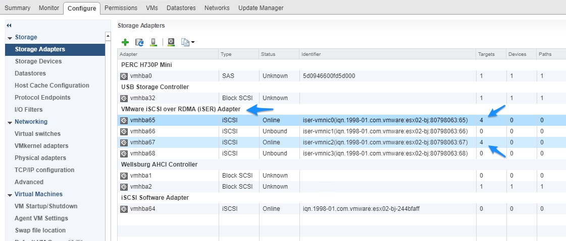

    Anyone got this working successfully WITHOUT using the inherent (and slow) iSCSI Software Adapter?
    I have a pair of Mellanox SN2700 connecting my esx hosts to iscsi block.
    I have installed the iSER driver (v1.0.0.1) and it loads.
    My HBA are ConnectX-4 25Gb.
    I can configure the Network Port Bindings. The host can see targets. but that is where it stops. No devices or paths become active.
    Moving to the inherent iSCSI Software Adapter. Add the Targets and all devices and paths are active and I have access to data stores.
    Am I wrong to think this should work without the vmware iSCSI Software Adapter?

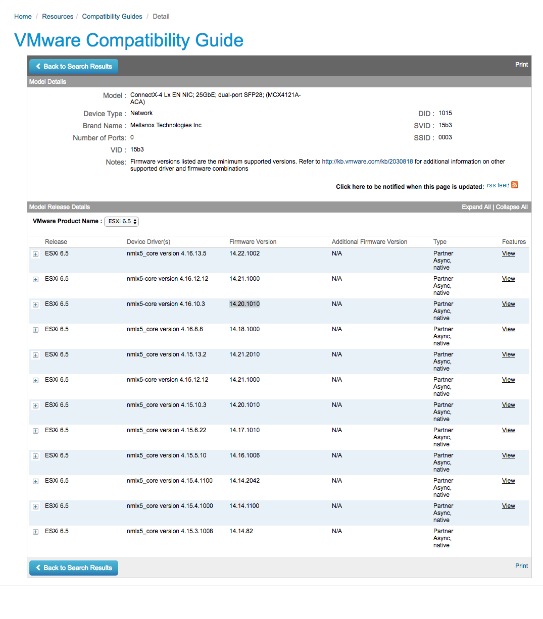

    After digging a bit, i think it might be a driver firmware mismatch.
    I am running
    Driver Info:
             Bus Info: 0000:01:00:0
             Driver: nmlx5_core
             Firmware Version: 14.17.2052
             Version: 4.16.10.3
    This page says that for that driver I should be running firmware v. 14.20.1010
    VMware Compatibility Guide - I/O Device Search
    - Pic attached.
    Now I just need to figure out how to upgrade the firmware, but by the looks of it, there are 2x newer driver versions too: 4.16.12.12 and 4.16.13.5.
    So I might as well upgrade the driver + firmware.
    Any thoughts?
