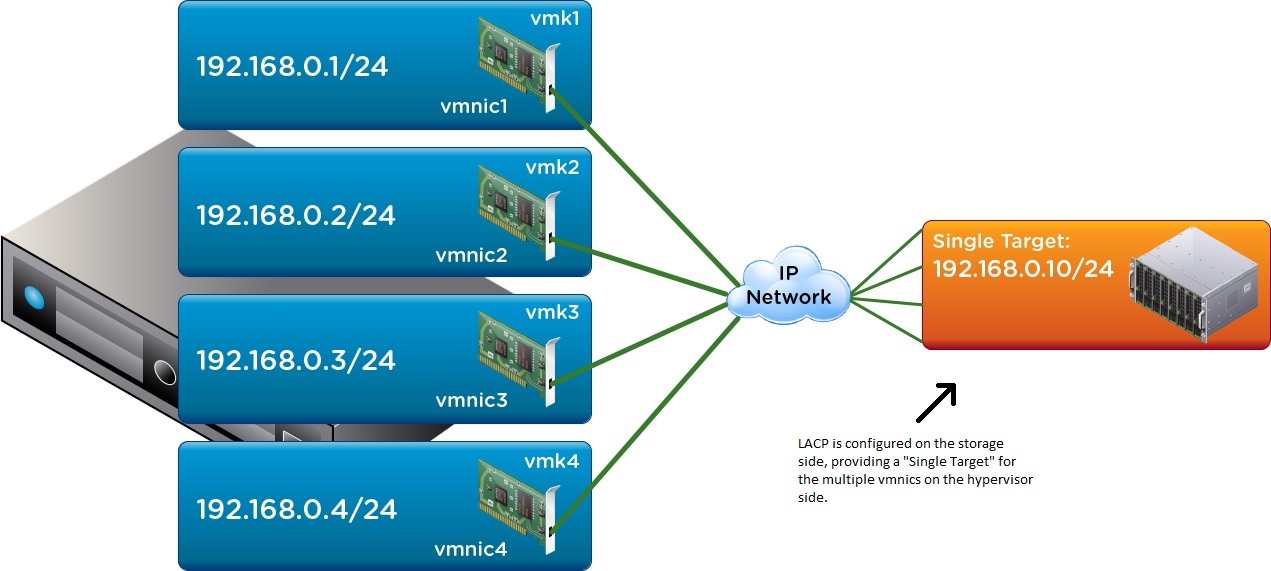

    Here's an overview of my lab environment as it is configured now:

    I was under the impression that my configuration was pretty much the recommended way of doing things, when utilizing port binding?
    In reference to the 2nd image ("When to use port binding") in this KB article: VMware KB: Considerations for using software iSCSI port binding in ESX/ESXi

    I've read through the articles you posted, but those again only discuss LACP and port binding on the hypervisor side.
    In my configuration, there is no LACP or link aggregation of any kind on the hypervisor, nor will there be. I will use MPIO though port binding to achive load balancing and failover on the hypervisor side.
    As I mentioned above, this is my exact configuration, only with 2 links instead of 4:
    This is why I don't understand why it's not working, and is also why I'm leaning towards thinking this might be a bug in the iSCSI boot logic on the hypervisor.

    In that diagram I can't remeber do they specifically state its LACP? or its just a grouped target?  As SANs like Dell Equallogics use a grouping or a VIP to the iSCSI controller system but it still doesn't use LACP.  The Group or VIP ip is just a management IP that then uses a MPIO driver to sort out which connection the traffic will enter / leave.
    The KB doesn't really specify anything about the storage side, except what is provided by the illustration. What's interesting is that they say that the following will/could happend if you don't do port binding on the hypervisor using the described configuration:

    When it comes to the iSCSI binding, you only have to bind the nics to the iSCSI vfk's when both port groups are on the same network.  If you had iSCSI1 on 192.168.5.x and iSCSI2 on 192.168.6.x it wouldn't require the bind.
    http://kb.vmware.com/selfservice/microsites/search.do?language=en_US&cmd=displayKC&externalId=2038869
