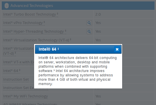

    This is what I found on Intel's website when I did a Google search for the processor in the laptop I'm using right now:
    I guess it's ok to use 64-bit vm's on my box if I understand the above correctly? Thanks again....

    Assuming you selected the correct model, yes, you're able to run 64-bit virtual machines in your laptop with the correct configuration.

    I copied the model number from the System Info page on my Linux laptop....thanks for your help, Richardson....greatly appreciated....
