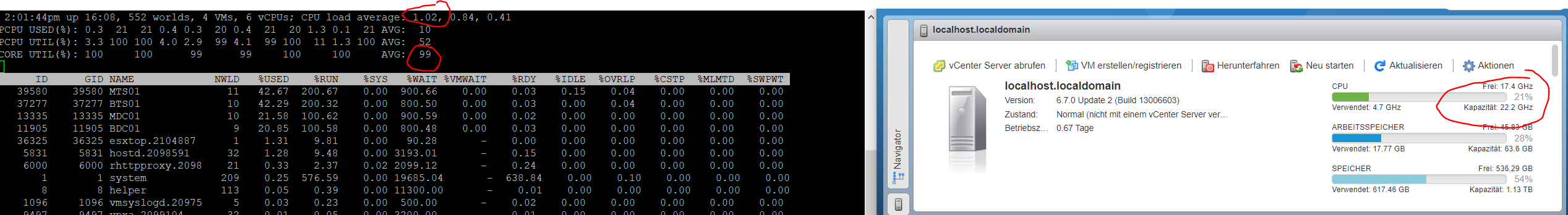

    Right, so esxtop show full utilized cores and threads.  At same time the consumed MHz of the vSphere Host CPU is just 21% (right side of the screenshot).
    If I do a stress test I can utilize the system to 100% in esxtop but just 22% in the vSphere GUI host CPU measurement.
    For me it seems like the host is not using the whole MHz frequenz or dont use every core. Really strange are two parameters
    1. 100% esxtop are 22% in the vSphere GUI (4,7GHz)
    2. 100% esxtop core util shows a same time a maximium of 10% pcpu utli %
    Best Regards
