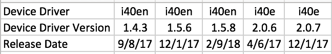

    driver version 1.5.8 is not the newest. Install version 2.0.7
    Most likely the problem is this.
    VMware Compatibility Guide - I/O Device Search
  • 3.  RE: Intel X710 nic woes
    Posted Apr 15, 2018 10:53 AM
    There are two different device drivers for this nic card, the i40en and the i40e. The latest version of the driver for the i40en is 1.5.8 and it came out later than the 2.0.7 i40e driver
    I am not even sure of the difference between the i40en and the i40e. This KB suggests that using the native mode driver is the way to go.
    VMware Knowledge Base
    Does the "n" in i40en suggest it is the native mode driver?

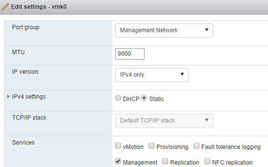

    Figure out the issue. We had jumbo frames enabled on the two switchports being used for the nics on the management network. When you assign these nics in the ESXi console to the management network, it makes a vSwitch with an MTU of 9000 which is correct. What it does not do is also make the kernel port with an MTU of 9000. The kernel port still had an MTU of 1500 and that was the issue. You cannot see that from the ESXi console you have to login via the web interface.

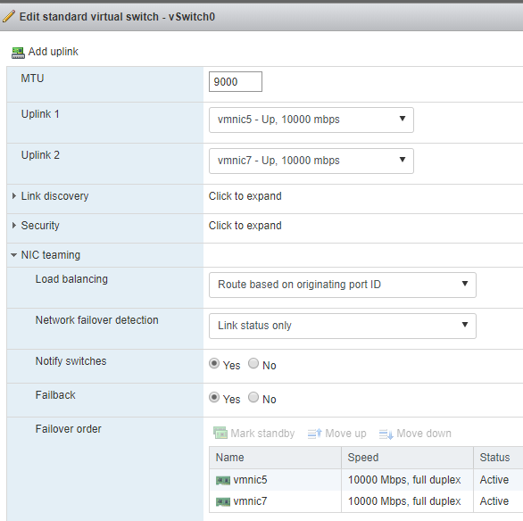

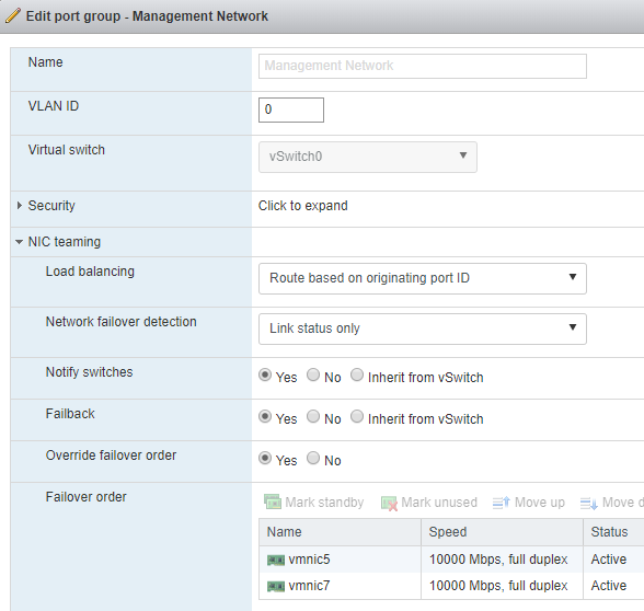

    I spoke too soon. There are two spots that nics in an active/active setup need to be configured, in the port group and the vSwitch. As soon as I make the two nics on the management network active/active and then reboot the host connectivity is lost. Pings to the IP address of the management interface start part way through the host booting up. Once fully started up, about 30 seconds later pings stutter and then stop completely. Below is the setup for the port group. vSwitch, and kernel. I have a 5 year old IBM server running ESXi 6.0 that is plugged into the same switch. It has two 10Gb Emulex nics in active/active for the management network and it is working fine.
