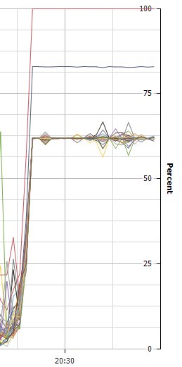

  • 10.  RE: Intel turbo boost not working, why?
    Posted Oct 22, 2013 04:38 PM
    Is this some kind of proof?
    It seems like 2 cores are working harder than all the rest cores, even thought all is 100% in task manager, someone please tell me if I am reading this right?

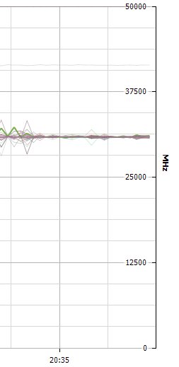

  • 11.  RE: Intel turbo boost not working, why?
    Posted Oct 22, 2013 04:43 PM
    YEEEEESSS here we go...
    Here you can see that all 32 vCPU (16 cores) are at the speed of 2.9 GHz.. hahahaha I am happy :-)

  • 13.  RE: Intel turbo boost not working, why?
    Posted Oct 22, 2013 04:53 PM
    OK, I just want to understand so help me, the screen dump form vsphere shows that 32 vCPU's are running 3.1 GHz. I am happy about that, this is much higher than the 2.6 GHz you state, and even higher that the 2.9 GHz that Intel states. Help me here...
