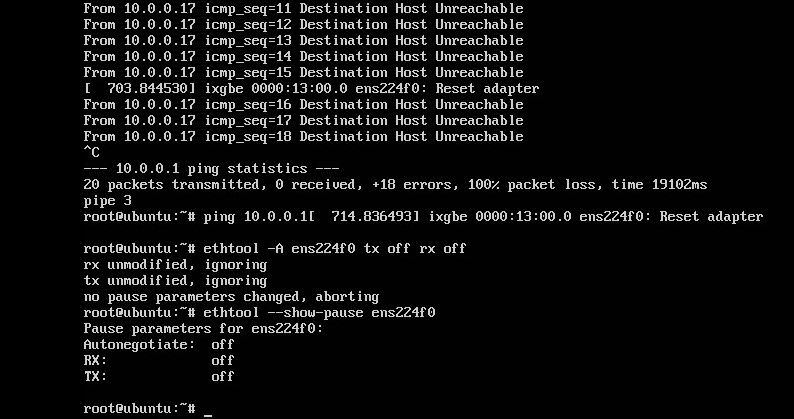

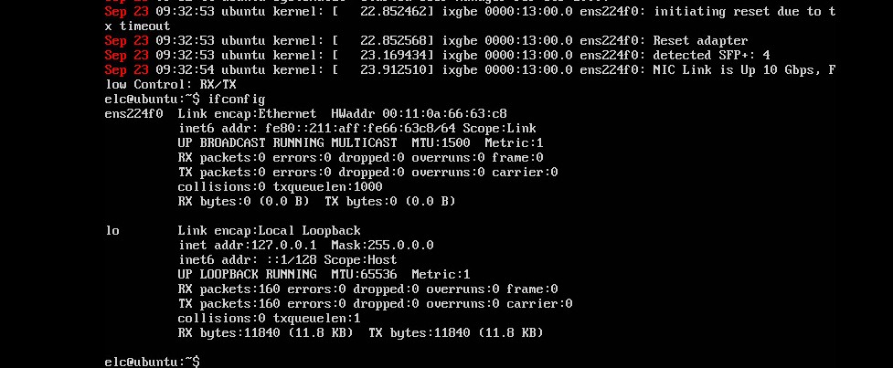

    after setting up ip to interface i'm receiving errors like:
    ixgbe 0000:13:00.1 ens224f1: initiating reset due to tx timeout
    ixgbe 0000:13:00.1 ens224f1: Reset adapter
    ixgbe 0000:13:00.1 ens224f1: detected SFP+: 3
    ixgbe 0000:13:00.1 ens224f1: NIC Link is Up 10 Gbps
    i've found that not only i have this problem. And there is already a post Intel Ethernet Drivers and Utilities / Bugs / #458 ixgbe 0000:01:00.0 eth4: initiating reset due to tx timeout
    the solution of problem in this bug report was in this command "ethtool -A eth4 tx off rx off autoneg off". But that is not working in my situation :smileysad:

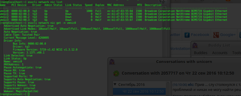

    Can  you please post the following output from your ESXi Host:
    esxcli network nic list
    and then:
    esxcli network nic get -n vmnic0

    1) esxcli network nic list   & esxcli network nic get -n vmnic0

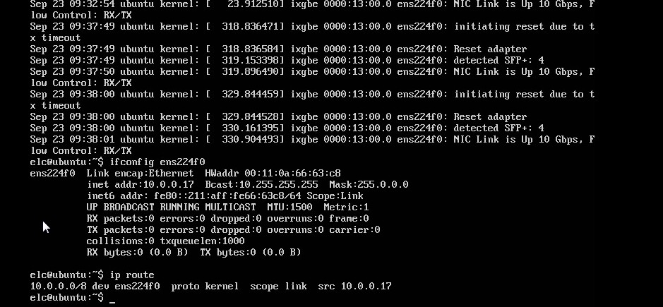

    3) the errors ... there is only only 1 error after booting in syslog.
    But when im setting up ip on interface and trying to use network (for example ping) im receiving new errors.

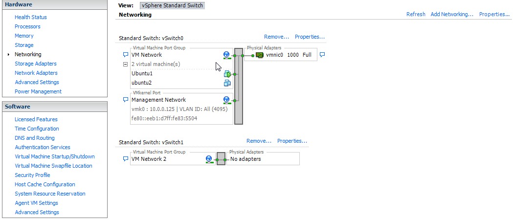

    PS: I dont know why, but i think the problem can be in vSwitch. Maybe i need to configure somehow vSwitch :smileyhappy:

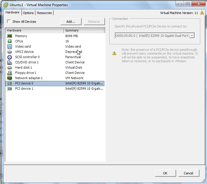

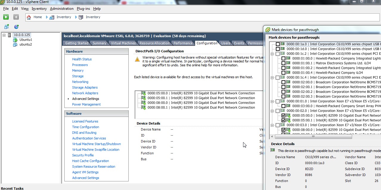

    thanks for the detailed informations. Why are you using a Pass-Through NIC?
    Better configure a vSwitch with your 10g interfaces and create a new VM PortGroup if you app is very latency sensitive use SR-IOV!

    Is it a single host or a Cluster?

    Its a single host. I have already configured vSwitch with my 10g interfaces all works ok. But i think that Pass-Through will be perfect solution. If there is a choice to virtualise or not i will chose "not" :smileyhappy: coz virtualization mb works whit almost the same speed but anyway little bit slower...
    i will try your link and report about result.
