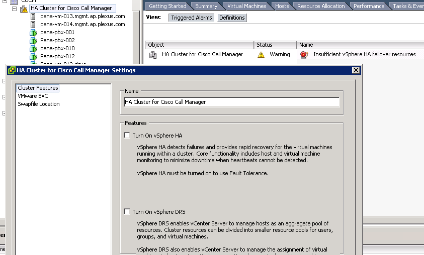

    Hi All. My End customer received an error “Insufficient vSphere HA failover resource”, they have tried to turn off the vSphere HA to see the error will goes off or not but the error message still there. Any step that i can provided to them to troubleshooting and overcome this issue? Anyone got idea about this error? Thank

    Looking at the screenshot that's not the error, its a  alarm warning  getting triggered when Insufficient resources available for  HA fail-over.
    If you disable HA this alert will not go(since its already generated before), you need to acknowledge it and clear it, If you are getting same alert  after clearing and without enabling HA means its a issue.

    Hi Zulhadi,
    It is not error it is alarm that is just notifying you as HA resources are not satisfied you can acknowledge and clear as our friend explained but with this you are going to clear alarm itself
    if you want to enable HA again for Redundancy you will face with same error again so crosscheck with HA pre-requisites i.e., 2 datastores for master and slave heart beats,atleast 2 ESXi hosts,
    Shared network(recommended) -,please go through all of this so you can enable HA and client feels happy!! (at ESXi summary tab you can find the message what are insufficient resources)

    It's an warning you need to acknowledge or clear the warning in the Alarms tab in vCenter, it will go out. The meaning of this warning is, you don't have enough resource in your cluster for failover.
    No need to disable HA for this issue. You can follow either one of the below option
    1. Disable Admission Control
    2. Change Admission Control to percentage based
    3. Don't set Memory reservation

    It is a warning  and you can  acknowledge or clear the warning in the Alarms tab in vCenter, it will be removed.
    Reason for  this warning is, there is no enough resource in your cluster for fail-over.
    Check which configuration is enabled there
    There two options in HA
    Cluster Resources Percentage Admission Control   -   you can mention the resource % over there to configure , if this is setting you can adjust and errro won't appear .
    Specify Fail-over Hosts policy  -  Number of host fail over  , since you have only two you must need enough CPU and RAM for this configuration.
    Here one host down  the another server should have enough capacity to manage the load by adding more resource  you can resolve the issue .
    You can refer below Links for more details and set your HA admission control policy
    vSphere HA Admission Control
    Best Practices for Admission Control

    Why would you want to ignore that warning, it is effectively telling you that if you loose a host you do not have enough resources in the remaining nodes to recover all your machines.  if you override this setting your customer are just ignoring a potential DR issue.
    their best bet would be to rationalize their resources to reduce their usage to under 50% utilization of purchase/build a third node for that cluster.
