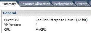

    Thanks.  In my most recent post I was referring to the "VM version" as shown on the Summary tab of the VM (see below).  The Guest OS is RHEL 5, 32-bit.  The host is ESXi 4.1.0, 348481.

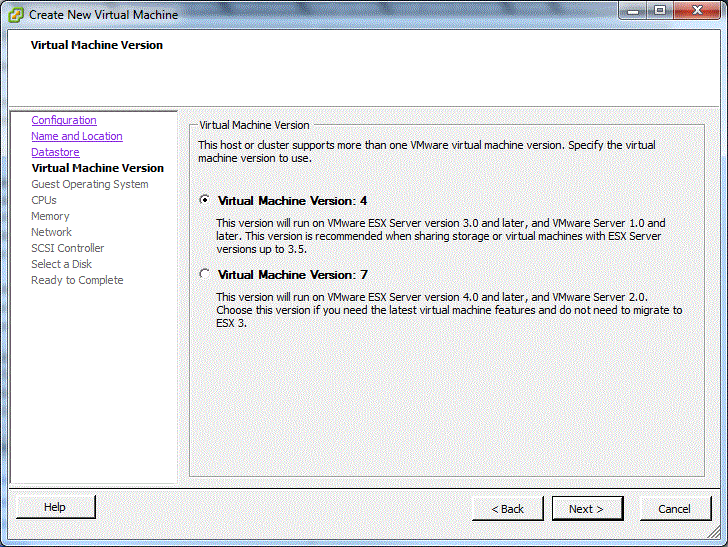

    It turns out that there was no network connectivity issue... we DID have network access.
    However, there is a pertinent solution to a problem here.  When we had created the VM using VM "Hardware" Version 7 we could not get VMware Tools to install (see error message in original post).  The resolution to this issue was to recreate the VM using VMware Hardware Version 4. To do this you have to select Custom when initially creating the VM, and select Virtual Machine Version 4 at the screen shown below.
