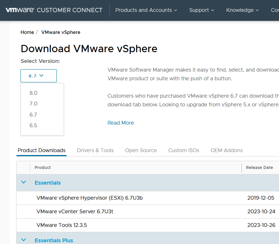

  • 4.  RE: Inquiry Regarding Network Card Driver Compatibility in VMware ESXi 8.x
    Posted Nov 19, 2023 12:38 AM
    Hi,
    You can download the iso from here: https://customerconnect.vmware.com/downloads/info/slug/datacenter_cloud_infrastructure/vmware_vsphere/6_7
    The way to get there if the link brokes is:
    1.- log in to vmware customer connect https://customerconnect.vmware.com/home
    2.- search in downloads for vmware vsphere.
    3.- There is a button where you can change the versión of esxi to download, 6.5 stil available:
    Also check this if you have any problems, here you can register for an evaluation license: https://customerconnect.vmware.com/en/evalcenter?p=free-esxi7
