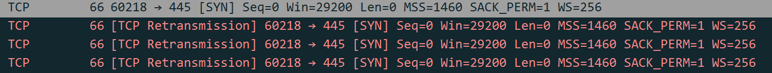

  • 9.  RE: Idm client exception: Error trying to join AD, error code [31], user [admin@corp.local], domain [corp.local], orgUnit []
    Posted Oct 28, 2018 01:41 PM
    According to the 6.x diagram TCP 445 to the DC isn't required from the vcsa, but I am seeing TCP requests from VCSA 6.5 to the DC.
    Captured with TCPDUMP on the vcsa.
    https://benjaminulsamer.files.wordpress.com/2017/02/2131180_networkportdiagram-vsphere-6x-referencetable-v2.pdf
  • 10.  RE: Idm client exception: Error trying to join AD, error code [31], user [admin@corp.local], domain [corp.local], orgUnit []
    Best Answer
    Posted Oct 30, 2018 12:10 AM
    If anyone else runs in to this problem the solution was to allow TCP 445 from the VCenter appliance to the Domain Controller.
    As of this writing vmware KB does not list 445 as one of the ports for vCenter Server and Platform Services Controller, however it's required to join the domain
    Required Ports for vCenter Server and Platform Services Controller
