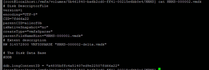

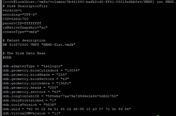

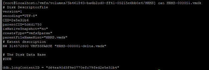

    To see what may be done, please provide the following:
    • a complete file listing, i.e. the output of ls -lisa from the VM's folder
    • the content of three small descriptor .vmdk files
    • explain which files you've modified so far, and what you've changed
    André

    I expanded the HRMS.vmdk file to 150G even though there were snapshots. The VM didn't come up so I deleted the snapshots using snapshot manager. I got an error of CID mismatch so I did some google and matched the CID and parent CID. Although I couldn't figure out about RW value. I registered a new vm from HRMS.vmdk and it came up! From data from previous month was not there After that I regerested a new vm from HRMS-00001.vmdk, it did come up but got stuck in startup repair thingy of windows 10. Thats all so far

    Did you let Windows run the startup repair, or did you power off the VM immediately after seeing this?
    It looks like you've modified the block size (the RW value) in the snapshot files too, which causes even more issues, because the new value doesn't match the binary structure anymore.
    Please run hexdump -n 32 -C HRMS-000002-delta.vmdk and post the output to verify the initial virtual disk size.
    Also let me know how much free disk space you have on the datastore to create a clone if necessary.
    André
    PS: Please consider posting the command output as text rather than as a screenshot.

    I let the windows repair a couple of times. It restarted the machine couple of times. It didn't work either of the time so I shut it down. I did change RW value on 00001.vmdk to match the original vmdk file. It only boot up after doing that.  Also, how did you know that the RW was changed?
    The RW value is the virtual disk's provisioned size in 512 Byte blocks. The shown value resolves to 150GB instead of the original 100GB.
