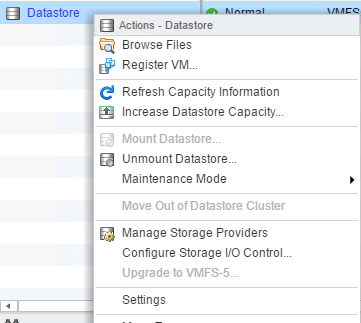

    Can you send us through a screenshot of the options you receive when you right click on the datastore? Also, what version of vCenter Server are you running?
    Here are some of the options I get, notice the greyed out 'Upgrade to VMFS-5...'. I can't upgrade because this is already VMFS5.
    Another thing to try would be to upgrade the datastore using esxcli on the ESXi host;
    esxcli storage vmfs upgrade -l Datastore
    Where 'Datastore' is the actual name of your datastore, case sensitive. If the upgrade fails, you may get some more information here as to why.
