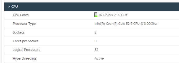

    I don't think you simulated the Scenario 2 properly from the 2018 whitepaper properly.
    On your subsequent screenshot, it shows the host CPU as 2 sockets x Xeon Gold 5217 (8c/16t) CPU. To simulate Scenario 2, your VM needs to have 16 vCPUs (twice the number of cores of the in one CPU socket), but you only allocated 8 vCPUs.
    As for seeing HT from within the OS, I don't think that is possible with VMware. What matters is how the vCPUs are scheduled into the physical core/HT. I think the purpose of the SAP/HANA using HT is to have access to same L1/L2 cache as 2 HTs in the the same CPU core share the same L1/L2 cache. All cores share the same L3 cache.
