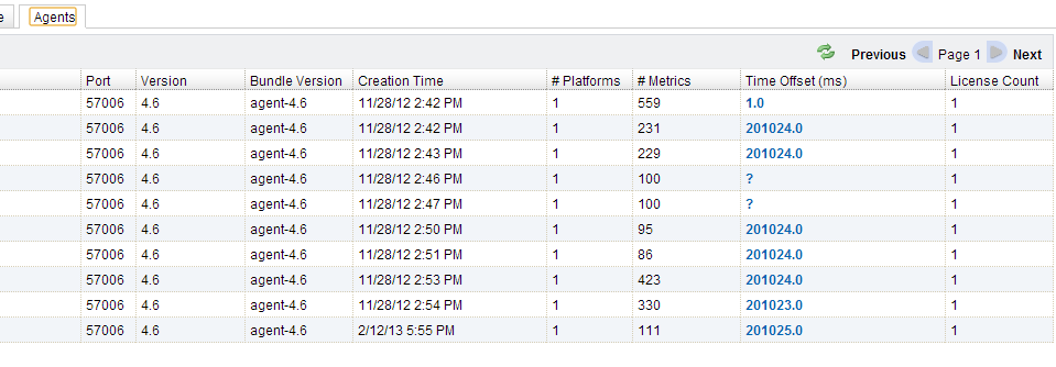

    you can check that here - administration -> HQ Health -> Agents (tab) -> Time Offset (column)

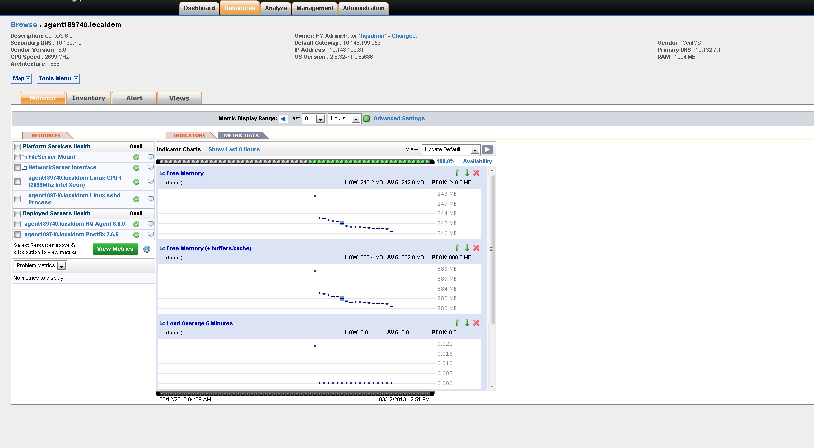

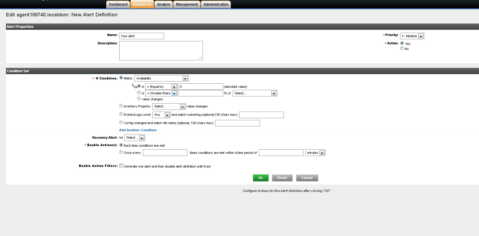

    if possible please provide 2 screenshots
    1) the resource you are creating alert for
    2) the alert defenition page
    I attached similar screen shots from my server so you can look at what to capture
    Thanks
    Nimrod

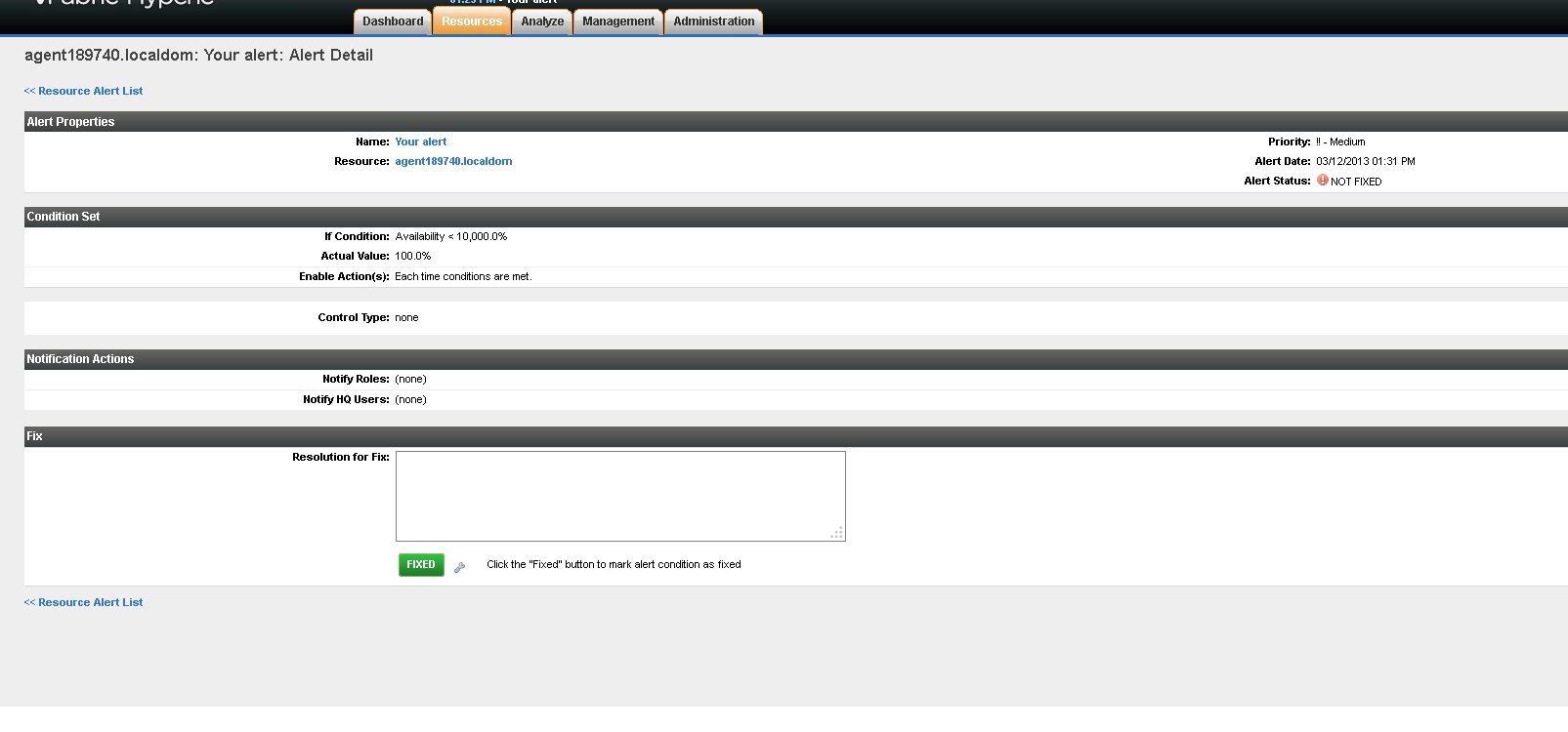

  • 8.  RE: Hyperic Availabillity metric alert
    Posted Mar 12, 2013 01:15 PM
    Hi
    if possible please provide 3 screenshots
    3)the triggered alert screen
    Thanks
    Nimrod

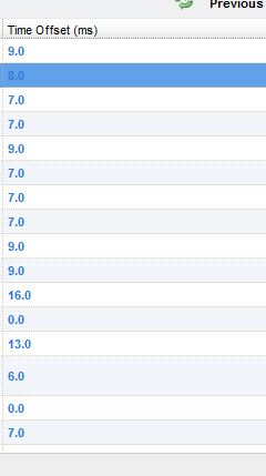

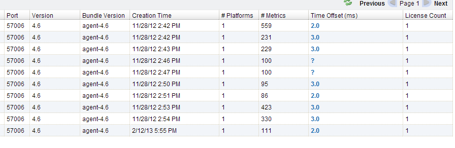

    In that offset column, if you see values greater than 1 min (60000 ms), then you should be worried.
    I try to keep them under 500ms. Anything greater than that is an indication that something is/or is about to go wrong.
    More info can be found in official Hyperic documentation - http://pubs.vmware.com/vfabric5/index.jsp?topic=/com.vmware.vfabric.hyperic.4.6/Troubleshoot_Agent_and_Server_Problems.html
    One more thing - as per my observations, windows servers (especially Win 2003) tend to have greater offsets.
    Installing and configuring NTP/Win Time Service usually solves all time-sync problems.
    Here is a sample of offset values you should see -

    Thank you Amurty, my hyperic clients/servers were not in sync. I've fixed the problem by configuring ntp on the servers/clients.
    My time offsets are much more reasonable now
