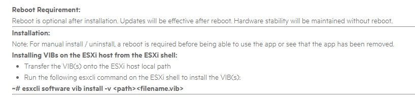

    is it possible to install /add the
    HPE Smart Storage Administrator (HPE SSA) CLI for VMware vSphere .vib file to an existing ESXi Host?
    We used the standard Esxi and not the HP one... with the ssacli....
    is a reboot necessairy or is it a problem for a existing host?
    thanks for help

    Ciao
    what is the version of ESXi you have installed?
    this is the link for the ESXi 7.0
    Software Details - HPE Smart Storage Administrator (HPE SSA) CLI for VMware 7.0 | HPE Support
    This are the instructions for installation (find on the previous link)
    Reboot is required

    hi,
    thanks for your help, is it really save for a production host?
  • 4.  RE: HPE SSA CLI manual setup
    Posted Mar 08, 2022 07:03 PM
    Ciao
    Yes you can install it on the production host
