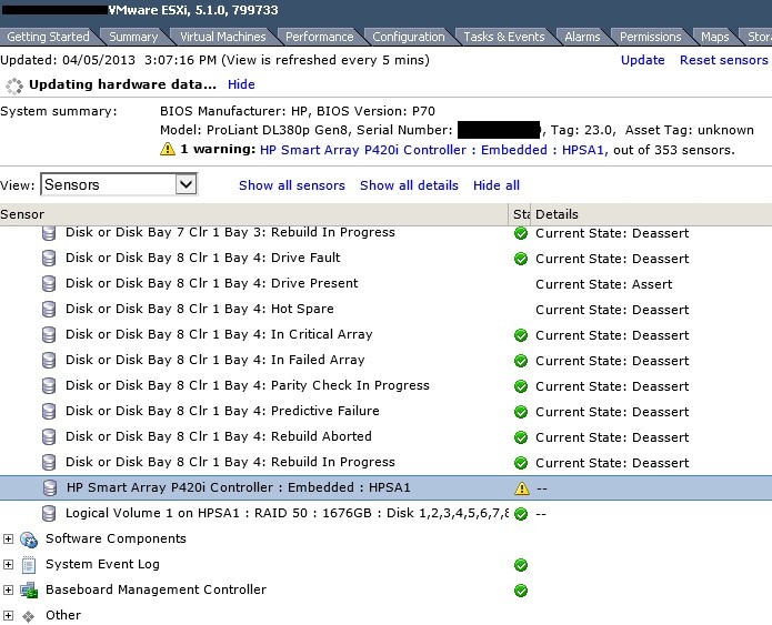

  • 5.  RE: HP Smart Array P420i warning
    Posted Feb 24, 2013 05:43 PM
    Hi a,
    here is a screen shot...
    everyting else is reported ok.
    Regards
    franz

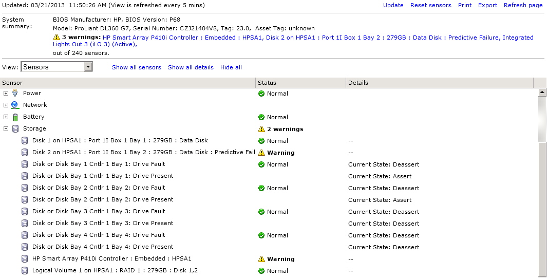

  • 28.  RE: HP Smart Array P420i warning
    Posted Mar 21, 2013 12:30 PM
    I encountered the same issue here, with DL360G7 / P410i.
    I can assure that the driver also will display disk failure in addition to the existing false one.

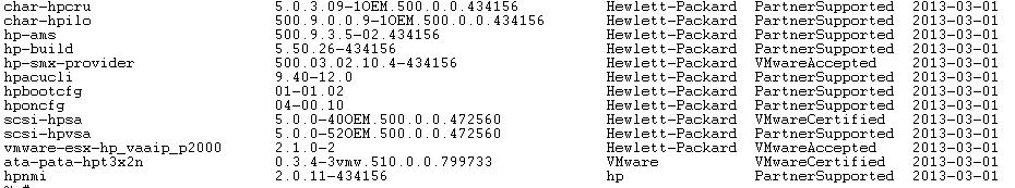

  • 33.  RE: HP Smart Array P420i warning
    Posted Feb 26, 2013 02:09 PM
    I already ran the latest SPP (Feb 2013) on my server so I've skipped that step.
    Then I installed the following drivers: http://h20565.www2.hp.com/portal/site/hpsc/template.PAGE/public/psi/swdDetails/?sp4ts.oid=5204443&spf_p.tpst=swdMain&spf_p.prp_swdMain=wsrp-navigationalState%3Didx%253D%257CswItem%253DMTX_f13f6dc749e348009133fcefd2%257CswEnvOID%253D4141%257CitemLocale%253D%257CswLang%253D%257Cmode%253D%257Caction%253DdriverDocument&javax.portlet.begCacheTok=com.vignette.cachetoken&javax.portlet.endCacheTok=com.vignette.cachetoken
    This gave me the following output:
    Installation Result
       Message: The update completed successfully, but the system needs to be rebooted for the changes to be effective.
       Reboot Required: true
       VIBs Installed: Hewlett-Packard_bootbank_char-hpcru_5.0.2.21-1OEM.500.0.0.434156, Hewlett-Packard_bootbank_hp-ams_500.9.2.0-11.434156, Hewlett-Packard_bootbank_hp-smx-provider_500.03.01.00.5-434156
       VIBs Removed: Hewlett-Packard_bootbank_char-hpcru_5.0.3.09-1OEM.500.0.0.434156, Hewlett-Packard_bootbank_hp-ams_500.9.3.0-13.434156, Hewlett-Packard_bootbank_hp-smx-provider_500.03.02.00.23-434156
       VIBs Skipped: Hewlett-Packard_bootbank_char-hpilo_500.9.0.0.9-1OEM.500.0.0.434156
    Rebooted the server and now indeed the Health Status in ESXi 5.1 (914609) is correct.
    However, if you look at the output of the SSH session you'll notice the drivers being used right now aren't the latest drivers.

    since our customer got response from HP-Support, to do the following steps:
    1) Remove the below “VIBs” from the local ESXi host by typing “esxcli software vib remove –n hp-smx-provider” for each vib listed below.
                    a) hp-smx-provider
    b) char-hpilo
    c) char-hpcru
    d) hp-ams
    2) Reboot the host after removing the VIBs and download the older version of ESXi 5 offline bundle and the version is 1.3.5 (26 Oct 2012) and the link is given below.
    http://h20565.www2.hp.com/portal/site/hpsc/template.PAGE/public/psi/swdDetails/?sp4ts.oid=5177950&spf_p.tpst=swdMain&spf_p.prp_swdMain=wsrp-navigationalState%3Didx%253D2%257CswItem%253DMTX_0f7de8802be4423db38c8cb200%257CswEnvOID%253D4115%257CitemLocale%253D%257CswLang%253D%257Cmode%253D4%257Caction%253DdriverDocument&javax.portlet.begCacheTok=com.vignette.cachetoken&javax.portlet.endCacheTok=com.vignette.cachetoken
    3) Reboot the ESXi HOST once again after installation of the Offline Bundle and check the status in the vCenter.
    So i didn't  try it now, but as other guys here recommend this step and use older vibs, it looks like it is the solution until HP fix this.
    Best regards

    This is the latest bundle that works;
    http://vibsdepot.hp.com/hpq/oct2012/
    The most recent (feb2013) contains bugs. All can be found here;

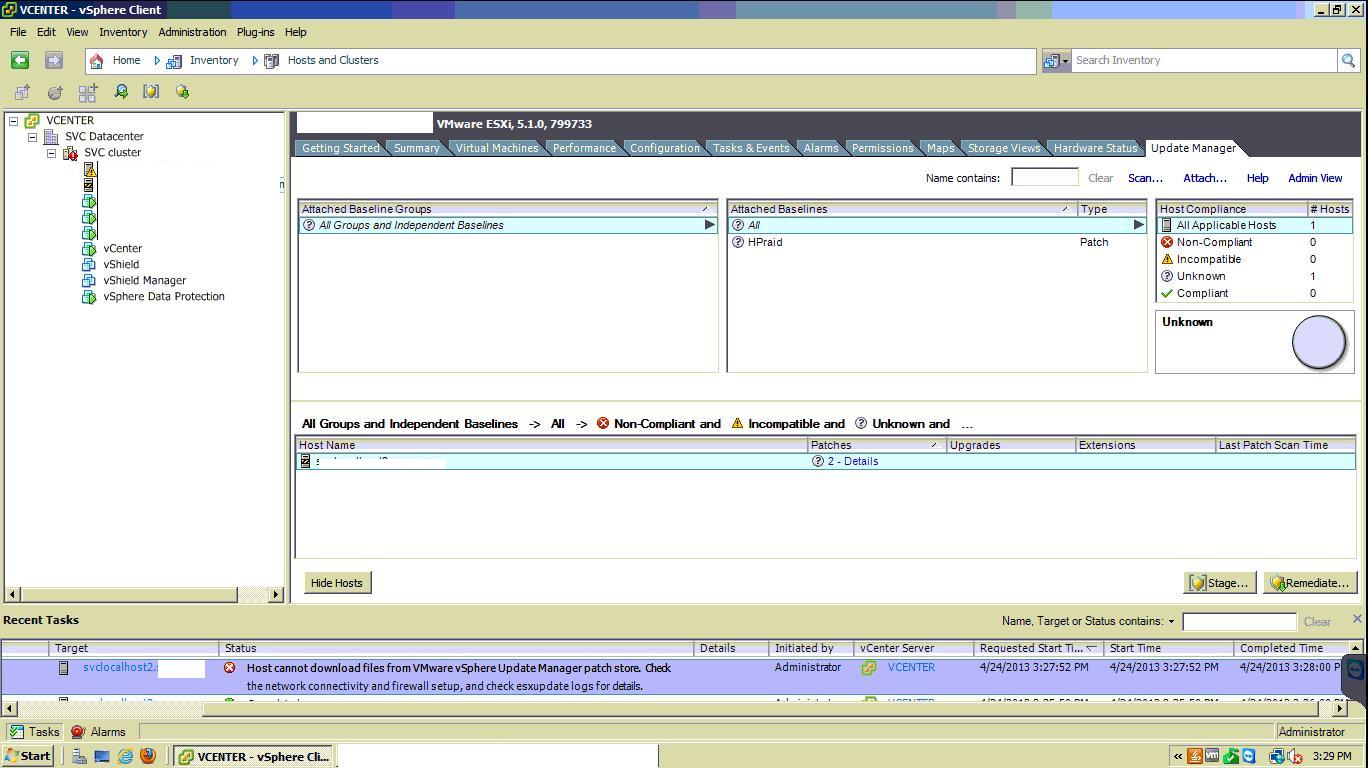

    Posted Apr 22, 2013 07:15 AM
    Hi guys,Appreciate could hv guide to use the Vmware update manager to do the bundle update.i have to do so after tried for several days.

    Hi Jarod,
    as i don't have a vCenter in front of me right now, i'm writing down the steps from what i have in my memory.
    • Download the offline bundle (it's a .zip archive)
    • Import the offline bundle into your patch repository
    • Add the new patch (i think it's called HP Management something something) to a Baseline
    • The rest is like with any other baseline: attach to host, scan, remediate
    • Hopefully be happy with no more false warning :-)
    Hope this could help me.
    Regards,
    Neal
  • 51.  RE: HP Smart Array P420i warning
    Posted Apr 24, 2013 08:37 AM
    Hi Nealsu ,
    Thanks for your guide,i having error message on "Host cannot download file from the vmware vsphere manager patch store .Check the network connectivity"
    I  manually attached the file from client and set  not automatically download from the web
    thanks
  • 52.  RE: HP Smart Array P420i warning
    Posted Apr 24, 2013 09:42 AM
    Did you check this KB article?
    http://kb.vmware.com/kb/2007398
    Which step throws this error? Scanning?
  • 53.  RE: HP Smart Array P420i warning
    Posted Apr 24, 2013 10:31 AM
    Hi ,
    i disable my firewall and antivirus on my vcenter (update manager),and disable the HA on the cluster.
    now it works,
    thanks

    /usr/lib/vmware/vm-support/bin/swfw.sh > /tmp/swfw
    /tmp # cat swfw | grep hpsa
    VMware_ComponentSoftwareIdentity.InstanceID="VMware:Hewlett-Packard_bootbank_scsi-hpsa_5.0.0-40OEM.500.0.0.472560"
                        InstanceID = VMware:Hewlett-Packard_bootbank_scsi-hpsa_5.0.0-40OEM.500.0.0.472560
                           Caption = scsi-hpsa
                       ElementName = scsi-hpsa
