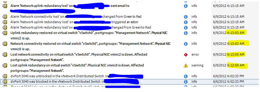

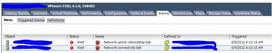

  • 23.  RE: HP Proliant Servers Important Update
    Posted Jun 08, 2012 03:07 PM
    Hi Markzz,
    The way I become aware of the problem was by connecting to the ESX host using WinSCP3 and then looking at the vmkernel logs located in the following location:
    /var/log
    The log would show the following error:
    Firmware hang detected. Severity code=0 Peg Number- Error Code=0 Return address=0
    Once you have opened the log file just do a search for 'Firmware Hang'

    Just a bump as we have had the same disconnects - and with the new Firmware, we are seeing less disconnects but I am not sure its fixed, I think the recovery is just faster - now I get two NICs going down - and no disconnected hosts - but the host will alarm about being isolated (because both NICs were down on the Management vSwitch at the same time??)
    And then the Host Isolation (but no Host Disconnect).
    And note the recovery times - its 1-4 seconds.
    These 580's use a single NIC card for the Quad Ports - so it may make sense to add another card as a 2nd NIC vs. using 2 ports on the Quad Card.
