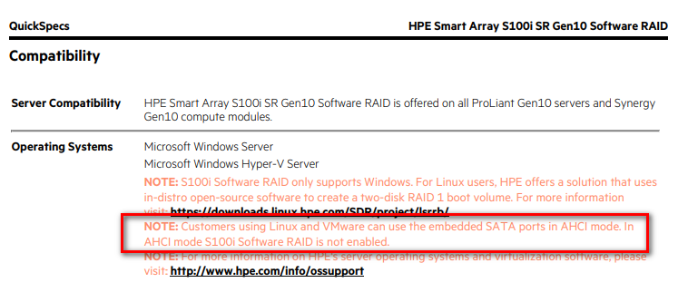

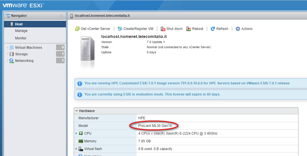

    Reading in the very confused HP's documentation I've found this:
    Putting the server in AHCI mode it works fine:
    As I've specified in the original post, I wasn't interested in RAID solution, I'd like only a cheap ESXi server working.
    I hope my experience will be useful to the community.
