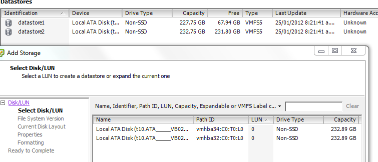

    Hi Guys,
    I have an issue that's freaked me out a bit. I created a mirrored array on a HP ML110 G7. The disks are normal SATA disks. I never thought much of it until I added an additional two disks for another datastore. When adding the datastore, it shows 3 disks...
    I have 4 disks, 2 raid 1 mirrors.
    What is going on?
  • 2.  RE: HP ML110 G7 Mirror disks showing as single disks?
    Posted Jan 24, 2012 07:31 PM
    You are most likely using the embedded Smart Array B110i SATA RAID Controller. ESXi only supports hardware RAID controllers like the optional P410 controller for your server model.

  • 8.  RE: HP ML110 G7 Mirror disks showing as single disks?
    Posted Jan 24, 2012 07:35 PM
    If the server has the HP B110i storage controller, then this is a software RAID controller based on the Intel ICH10R chipset.  ESXi does not support software RAID with the drivers that come with ESXi so the best you'll get is individual disks.

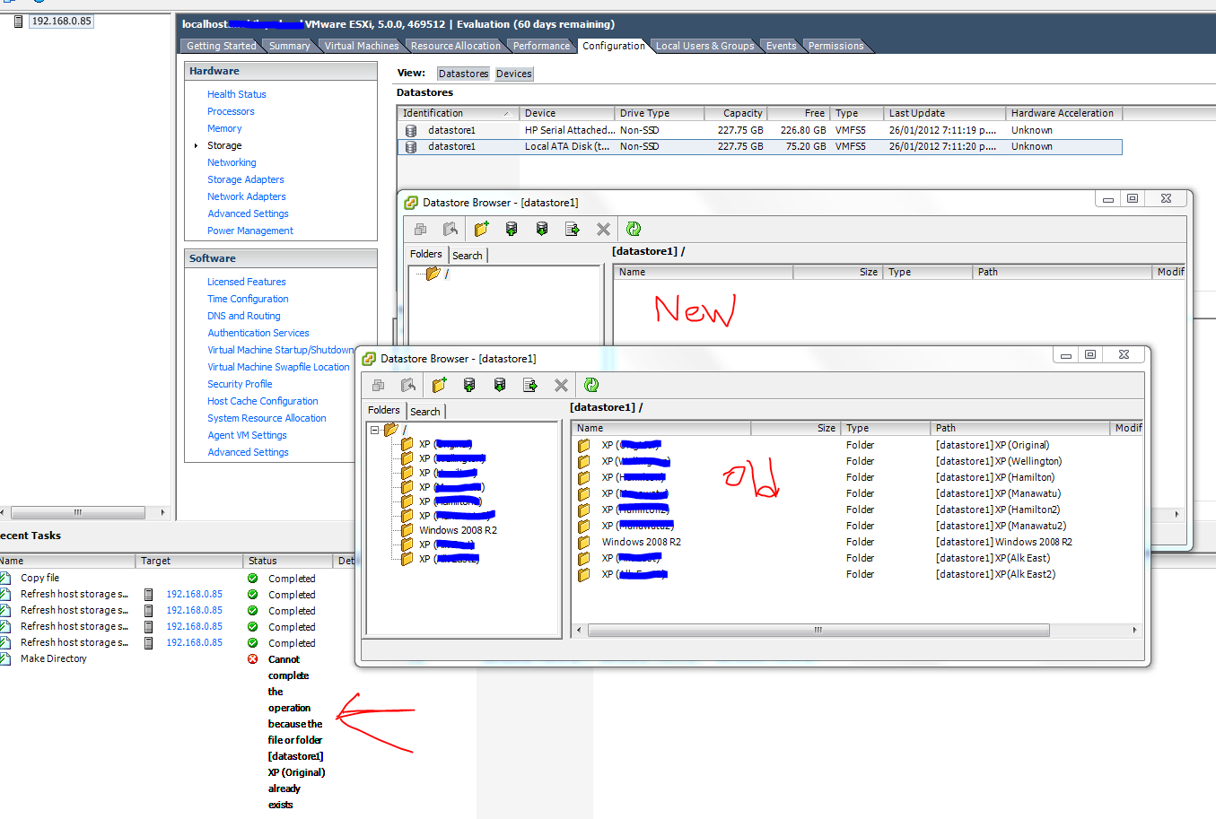

  • 16.  RE: HP ML110 G7 Mirror disks showing as single disks?
    Posted Jan 26, 2012 06:19 AM
    Hi guys,
    I now have the new ESXI up and running on the new array. I broke the old sata raid, it was only a mirror anyway. I've plugged the single disk in and now I can see the old datastore as well as the new data store.
    However, when I copy the VMs, nothing seems to happen.
    When I try to make the same directory now on the new partition, I get an error that it already exists... is it actually copying or is something weird going on?
  • 17.  RE: HP ML110 G7 Mirror disks showing as single disks?
    Posted Jan 26, 2012 06:24 AM
    Nervermind, just had to rename the datastore.
