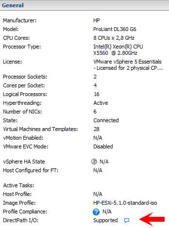

    In vmware ESXi 5.1 on HP DL360 G6 can not run passthrough for the network adapter. NIC has 82576 chipset and supports Single Root I/O Virtualization. Vmware still want me to reboot a host to start running a network adapter in passthrough mode. After rebooting is same. Here are some logs from dmesg:

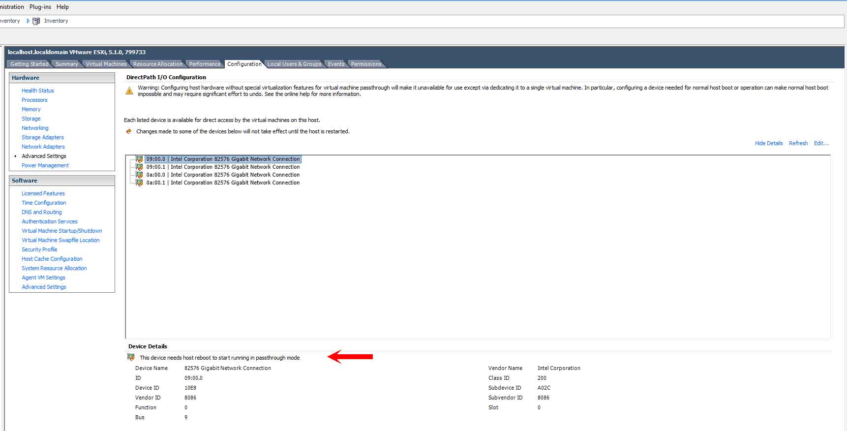

    In addition, I attach screenshots from vmware:
    DirectPath I/O is supported...
    After rebooting I have a same info: "This device needs host reboot to start running in passthrough mode" :smileysad:

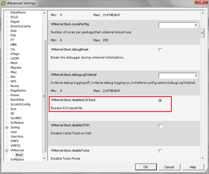

    I have the same issue on asrock whitebox server with HP NC364T PCI Express Quad Port Gigabit Server Adapter. I have found the solution on VMware Technologies Blog: PCI Passthrough (Direct-IO or SR-IOV) with PCIe devices behind a non-ACS switch in vSphere.
    Select the host and navigate to Configuration > Advanced Settings (Software) > VMkernal > Boot. Search for a parameterVMkernel.Boot.disableACSCheck and enable the check-box.
    It has worked for me. I have dedicated the network cards to nested esxi VMs.
