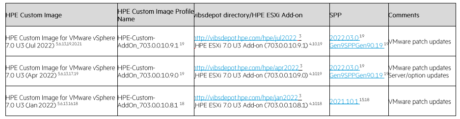

    According to HPE the SPP and HPE Custom image must be:
    Must maintain the Driver and FW Revisions from the 2021.10.1 SPP and the Jan 2022 HPE Custom ESXi 7.0U3 Image
    https://vibsdepot.hpe.com/mapping/SPP-HPE_Custom-Image-vibsdepot-mapping-Gen9-later.pdf

    This document covers the ranges: SPP-HPE_Custom-Image-vibsdepot-mapping-Gen9-later.pdf
