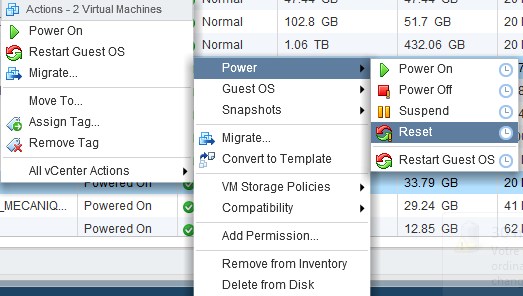

    Thanks but shutdown guest os is not available while vmtools are installed on both VM:

    Posted Mar 02, 2015 08:15 PM
    I was actually thinking of the Windows based vSphere Client rather than the Web Client.
    André
