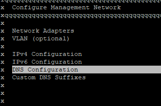

    Posted Aug 27, 2021 12:51 AM
    Update ur ESXi hostname/DNS/DNS suffix on DCUI . Make sure the DNS had this entry already. Create a new entry for vcsa fqdn even
