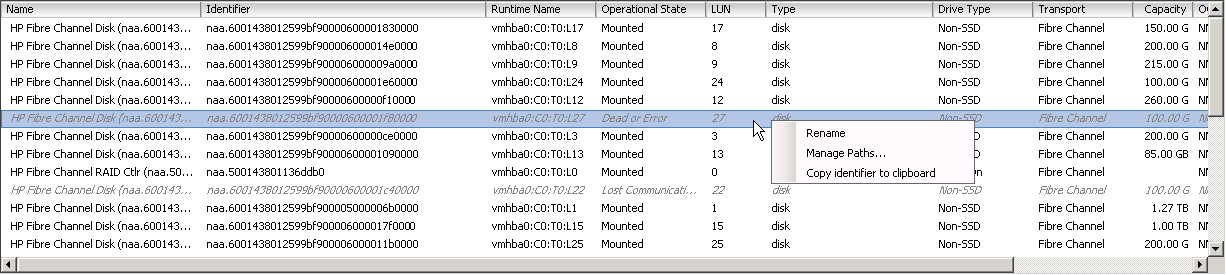

    Hi There! I am the IT Systems Administrator for my organization where we have HP P6300 storage connected to our ESXi5 cluster. Usually, if we require a new Vdisk for any VM, we create a new vdisk in storage and add it as a new datastore in the Vsphere, then we create the vmdk file inside that new data store. I was to remove one disk from one virtual server. The steps i follow are as below:
    1- Remove data from disk
    2- Remove disk from virtual machine and delete vmdk file
    3- Remove data store from the data store cluster
    4- Unmount datastore
    5- Delete the data store from vCenter (Inventory \ Datastores and Datastore Clusters \ Right Click on Datastore and Delete)
    6- Unpresent the vdisk from ESXi hosts
    7- Delete the vdisk from storage manager.
    But i made a mistake and missed STEP No. 4 and 5.
    Now i can see the attached message whenever i try to remove it. Any guidelines to solve this problem and remove this missing datastore from the vCenter?

  • 5.  RE: How To Remove an Abandoned Datastore?
    Posted Jul 17, 2013 08:07 AM
    Hi Julien,
    Seems helpful but this is what i am getting to see in my vCenter manager...
  • 6.  RE: How To Remove an Abandoned Datastore?
    Best Answer
    Posted Jul 17, 2013 08:10 AM
    OK you have a dead paTh. The only way to fix that is to reboot the host.
    regards,
    julien
  • 7.  RE: How To Remove an Abandoned Datastore?
    Posted Jul 17, 2013 09:01 AM
    julienvarela Mustafa
    Thanks for your help guys.
    I rescanned all the data stores and devices from configuration tab and tried to delete the datastore and whoop...its gone. Thanks for your help though. It was prompt.
    Cheers.
    Ali
