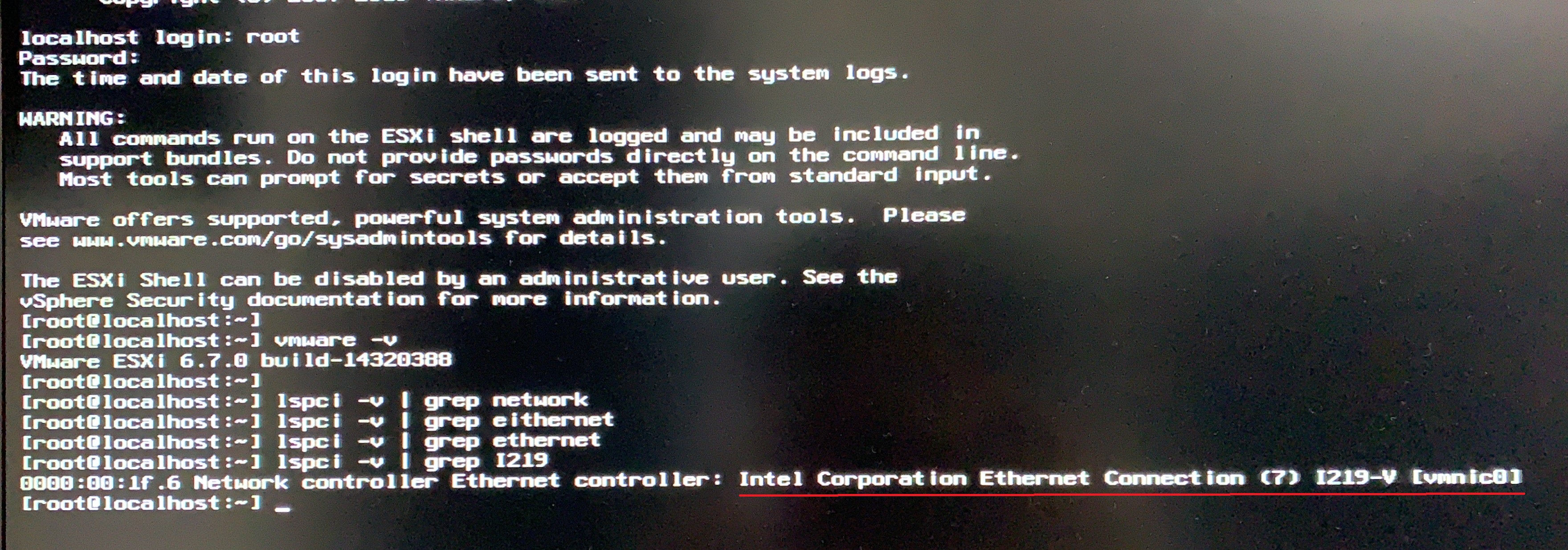

    NIC : Intel I219-V (7)
    I downloaded ESXi's image file from My VMware, boot up from this image, but Install progress was stopped cause by "No Network Adapters".

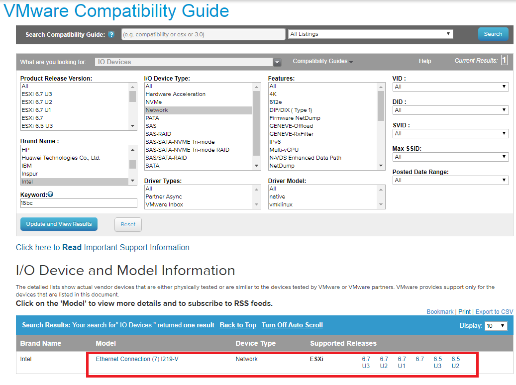

    I confirmed the compatilibility this LAN module and each ESXi versions on "VMware Compatilibility Guide", but it seems that this LAN module's driver file is contained with ESXi 6.5 U2 or later versions.
    And also, I used ESXi shell terminal and checked the LAN module recognizes from ESXi.
    But it does not work, every time appear this error.
    I don't understand why this issue happens.
    Would you tell me if you have good information.
    Thank you.

    As you say, I created the customize ESXi Image use ESXi-Customizer-PS.ps1, but it didn't work.
    I checked this site, it seems there has not I219-V (7) (devID:15bc) driver file.
    Namely, I can't create image file what include this driver even if use this script.
    I think that If create using the script, need the .vib format driver file, but I have not be able to find it.
    Would you know the other ways?

    As daphnissov says, in the worst case I have to prepare the new LAN card what adaptable for ESXi.
    However, I am not convinced why this installation fails even though it is listed as an applicable driver in VCG. (I guess that might be the "big problem" AlessandroRomeo68 says ...)
