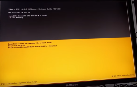

    I have an ESXI hypervisor installed on a server with centOS installed as a guest operating system and have it's terminal opened. I want to open Direct Console User Interface (that black and yellow configuration menu) as shown below. I have tried Alt+F2 but DCUI does not open

    Actually, I want to open that black/yellow screen. The picture shown is what I want to open (I don't have it opened already).

    When you boot the server it should directly take you to the black and yellow screen that is shown in the picture. What do you currently see on your screen?
