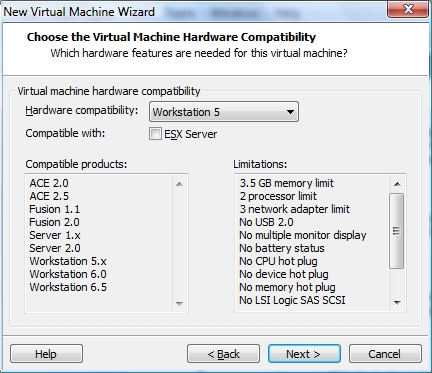

    There's Other way for Importing VM from Workstation to ESX/ESXi but it may look funny.
    When Starting the Creation of new VM in Workstation, Chosse "Custom (advanced)" and after that in "Virtual Machine Hardware Compatibility" select "Workstation 5" and check th "ESX Server" check-box.
    You have to do it, if you know that you will transfer it to ESX/ESXi server and by doing this, you wouldn't need Converter.
    But I prefer Converter myself.
