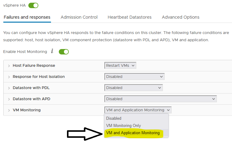

  • 9.  RE: How to monitor application in VMware HA
    Posted Sep 20, 2022 06:32 AM
  • 10.  RE: How to monitor application in VMware HA
  • 11.  RE: How to monitor application in VMware HA
    Posted Sep 21, 2022 11:11 AM
    Seems I am near to my query.
    You have shared SDK guide in above link so that we can built application monitoring support for a custom application. This will help to monitor application thru VMware HA and restart it in case of application failure. Does VMware have any pre built-in application monitoring support for famous applications like (IIS/apache or MS SQL/Oracle/PostgreSQL) ? OR VMware does not have any pre built-in support for any application monitoring and have to use SDK guide for application monitoring support. Correct ?
