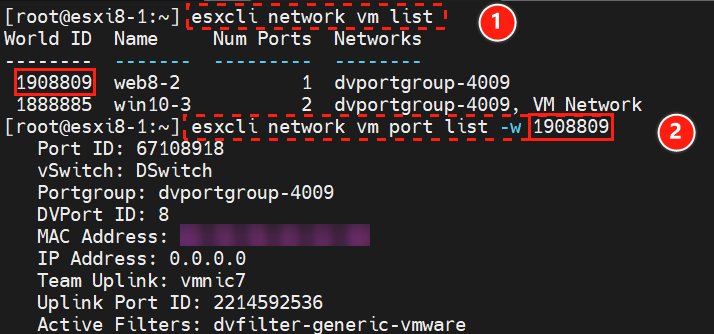

    Besides using esxtop tool, we can also use esxcli network command to find every VM's Team Uplink.
    1. Using esxcli network vm list to find the target VM's World ID.
    2. Using esxcli network vm port list -w <world-id> to show target VM's Team Uplink
