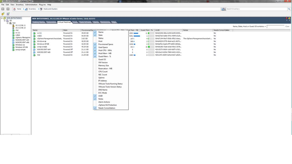

  • 6.  RE: How to find a VM through MAC only
    Posted Jul 11, 2013 02:48 AM
    Goto the virtual machine in Hosts & Clusters View in vCenter. Now right click on the list of the columns on your right side. You can search based on the following properties as shown in the screenshot...
