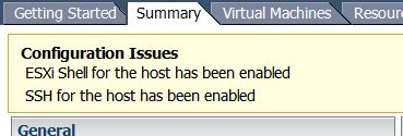

    Hi all,
    I had problem in vCenter Server 5.0.  Poisonous (for me) alert /warning about fact than I have enable local and remote shell.
    See picture below...
    Solution? Disable this by setup:
    Configuration - Software - Advanced Settings - UserVars - UserVars.SuppressShellWarning  = 1

    Hi DSTAVERT,
    I want and I need to enable local and remote shell access.
    I don't want to show warning for these.
    After restart of management agents or restart of esxi 5.0 warning is shown again.
    I know that restart works in vSphere 4.x but only my tip helps in version ESXi 5.0!
    Try it and you'll see ...

    I realize that this an old post, but today I also wanted to lookup how to disable the SSH warning in Vmware, while still having SSH enabled on the host.  I did not see the answer here in the thread.  I did find the answer, so I thought that would share with this thread as well.
    Go to your host, click the configuration tab, click “advanced settings”, go to UserVars” and scroll all the way down to “UserVars.SuppressShellWarning” change the value from 0 to 1.
