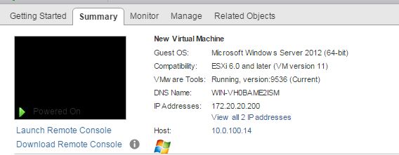

    I successfully added 1 VNIC to Virtual Machine and tried to ping from VM to its Gateway which I created on Physical Switch. now I am not able to ping this VM from LAN and from VM to its SVI.

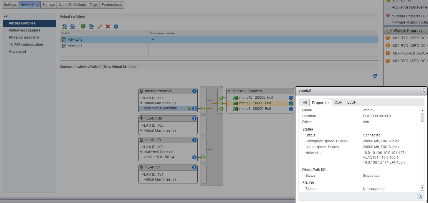

    1: Create a  Separate Port Group for that VLAN (172) inside Virtual Standard Switch

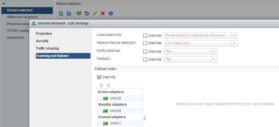

    2: Assign 1 active Up-link Port & 1 Standby Up link Port to that Vlan (172).

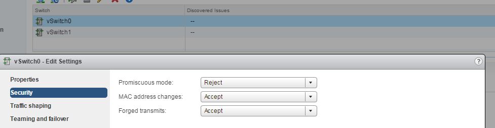

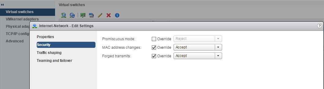

    3: Inside Port Group allow Security Setting

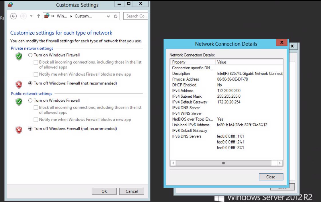

    5: Assign IP Address to VM ( 172.20.20.200). Its Gateway address (SVI L3 Interface) already created on Physical Switch so VM can ping it directly.
    6: Firewall already disable on Windows Server and Correct Network setting applied also

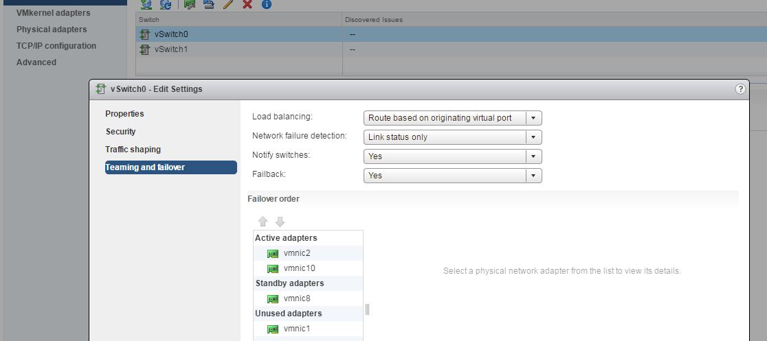

  • 6.  RE: How to configure and find 2 NICs in VM
    Posted Jul 17, 2017 07:03 PM
    The Ports are trunk (Switchport Trunk allowed vlan all) on Physical Switch and I also check in UCS Manager that Vlan already added.
    Did my Configuration are correct related with the Standard Switch and Port Group ?
    If Yes then what are other possible options we need to check?

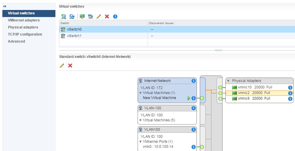

  • 7.  RE: How to configure and find 2 NICs in VM
    Posted Jul 17, 2017 07:27 PM
    The VM's settings seem to be ok, as there's not much that can go wrong anyway. If the physical port settings are ok as well - as you confirmed - it may be some configuration in the UCS Manager that needs to be done.
    The observed IP ranges in the vSwitch information pop-up you posted, show only two VLANs for which traffic has been detected. Now this is only a observation of active traffic on the vmnics, but maybe it helps to further troubleshoot the issue.
