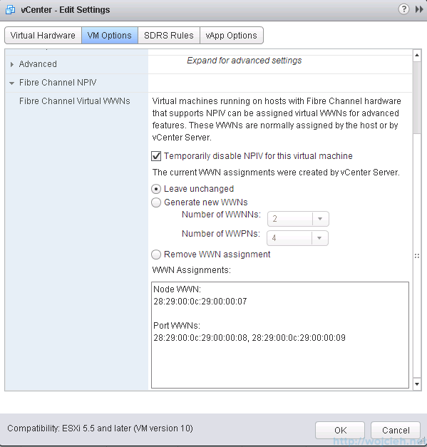

    This is a picture from web as sample. This picture show us single node WWN and two port WWNs. (Your case, single node WWN and four port WWNs.)
    I think you can use these generated WWNs for your storage network. But do they not working?
    And if you meet any error message, please share us it.
