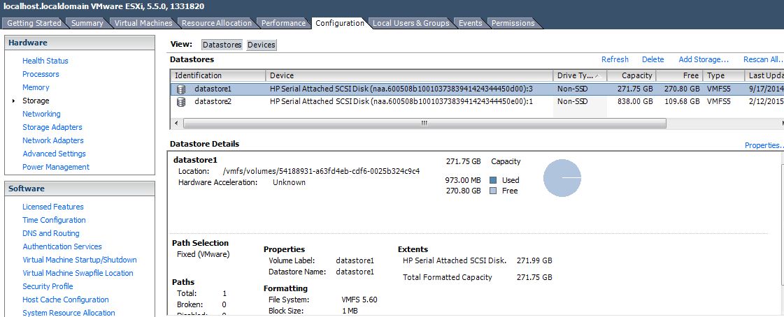

    Hi,
    I have HP Proliant DL 360 G6 Server.
    My colleague, installed VMware ESXi 5.5.0 on it.
    now, he has already resigned, and can not be contacted.
    How do i know whether, that server has already configured with RAID or not?
    And these are screenshots from my system:

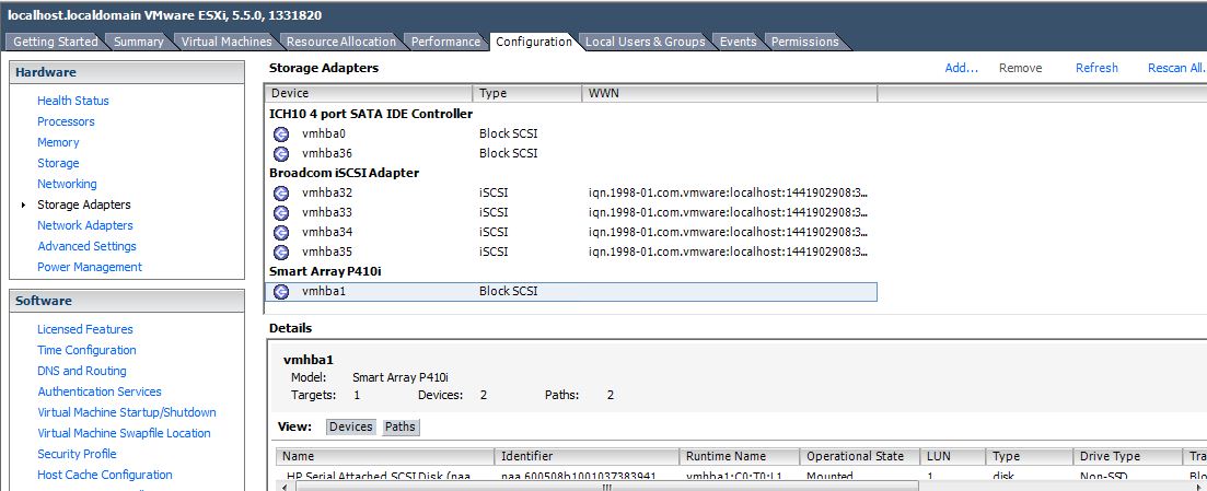

    vmhba1 is showing HP Smart Array P410i which is the RAID Controller Card that means your server is RAID configured.
    Else you can reboot the server & press F5 during initialization of the RAID controller you can view from there
