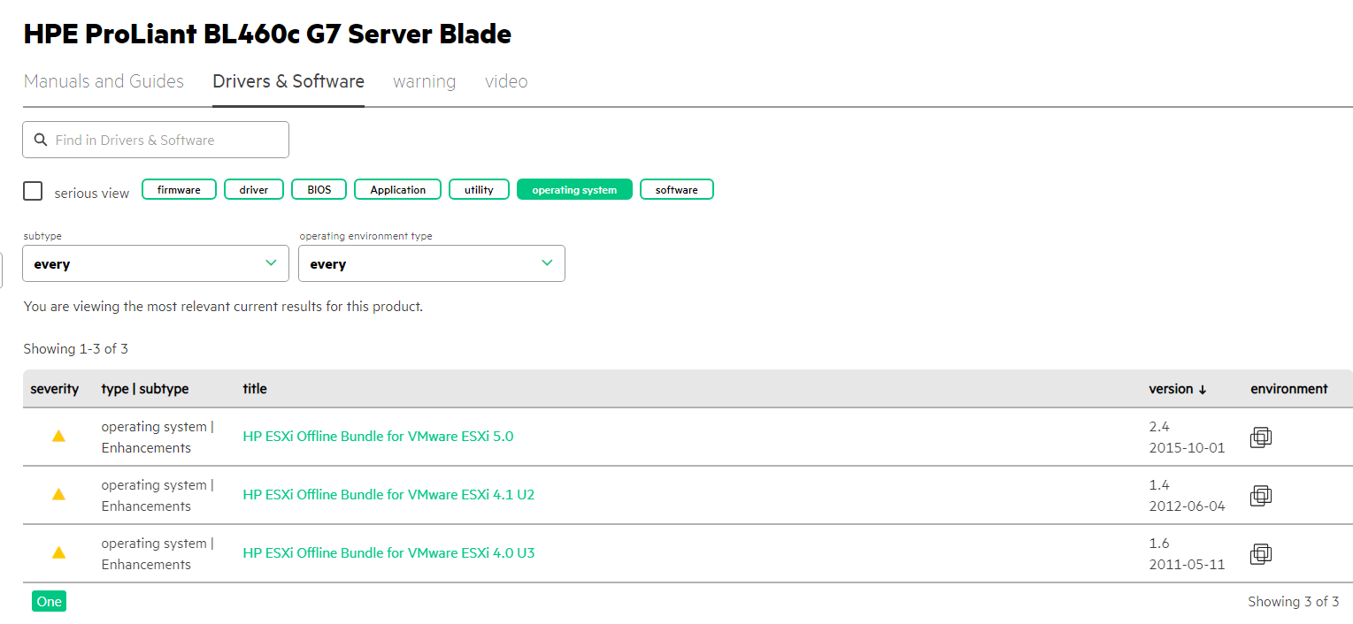

    Thank you all.
    It doesn't seem to be accurate information, but I think it supported only up to about 5.0 as the screen below.
