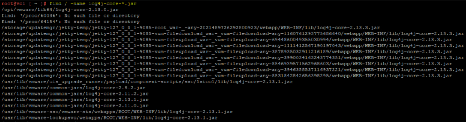

    log4j is not a installable package, it is a java file bundled with other installed packages. Meaning every installed package with log4j could theoretically have a different version. As you see in that output, there are at least 3 different versions there .
    So just follow the KB to get the workaorund-https://kb.vmware.com/s/article/87081 ..Actual patch for vCSA will come in a future release.
