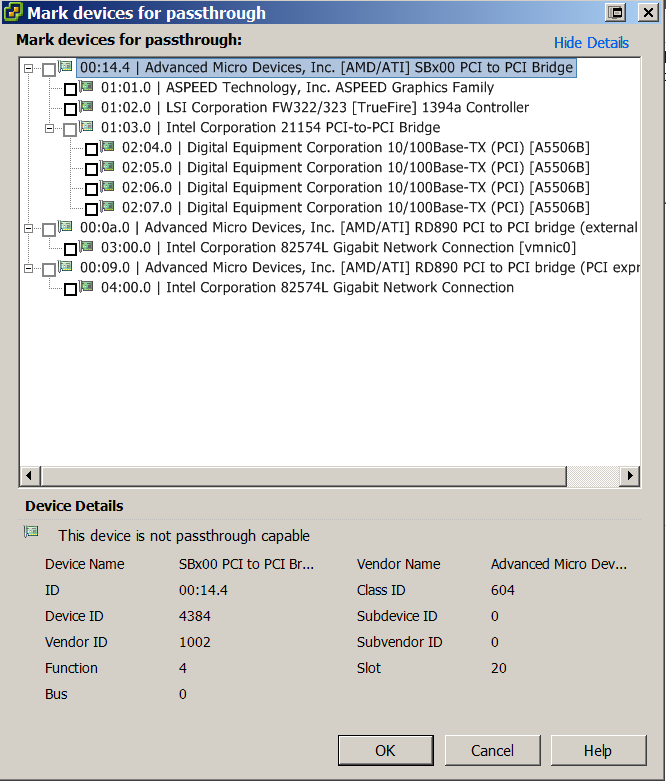

    After some investigation I realized that my network cards were actually installed correctly but they were automatically made available for passthrough
    Now my next question is this, how can I configure these to be available at host level?
    Here is what the PCI tree looks like
    I wonder if the cards are not available at host level because they have to be manually added or it is simply because the quad NIC card is quite old and it might not support features that
    are needed at this level (host level) One things that comes to my mind is 802.1q labeling not supported although this would be odd since this card was server grade card. Anyway, great card for someone who needs to simulate network appliances. I wish my MB had more PCI slots because I have more of these
    The above nics do not show at host level

    I'm struggling to understand the appeal of running a 10 year 10/100 NIC under the latest release of ESXi.
    Being a PCI card, the A5506B can't be used in passthrough mode. So, that's not going to be a problem.
    The driver you're using was a quick port intended as an experiment in running ESXi 5.1 under Hyper-V running on Windows 2012.
    You can follow the discussion in this thread: Vmware ESXI within Hyper-v (server 2012) networking issue
    The legacy NIC on Hyper-V emulates the DEC 21140 using the 'tulip' driver. I don't recall anyone using  it on a physical NIC.
    The diffs to the linux sources are in the thread, as are instructions on building your own version of the driver.
    One thing you will need to do is to get the PCI ID for the A5506B (as told by 'lspci') into /etc/vmware/driver.map.d/tulip.map.
    You might be able to get at least one of the ports on the card to work this way.
    To get them all lit up you'll likely need to fiddle with the driver source.

    There is something that I don't understand about the above statement:
    "PCI is not passed through"
    I just added a Broadcom NetXtreme BCM5704 2x1Gbe card and this like it could pass through ...see below
  • 8.  RE: How do I manually load a network card driver?
    Broadcom Employee
    Posted Jan 23, 2015 02:56 AM
    It's an old PCI card that was probably designed without IOMMU support.
    You're certainly welcome to try adding it as a VMDirectPath device.
    If it doesn't work, /var/log/vmkernel.log might give you a hint why it failed.
