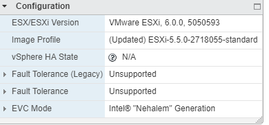

  • 3.  RE: How do i determine if a custom ESX is installed ?
    Posted Mar 26, 2018 09:24 PM
    Please check the below screenshot.

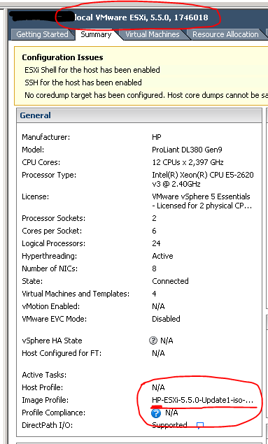

  • 7.  RE: How do i determine if a custom ESX is installed ?
    Best Answer
    Posted Mar 26, 2018 09:57 PM
    OK Yoy got me on the right track ! Not exactly the same but close enough for the definite answer, thanx !
    For clearity we use a vsphere client (not a webclient) and the ESX it's not a 6 version.
    So the summary looks, a bit different, like this :
    Oops my bad, it was an update1
