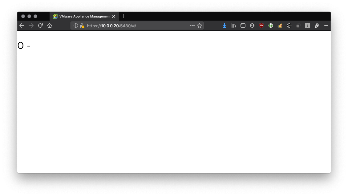

    Now the button work and got a message everything was alright and took me back to Management. I ran the update and it got stuck on starting (0%) for hours. I left it alone even more hours and when I came back I got this:

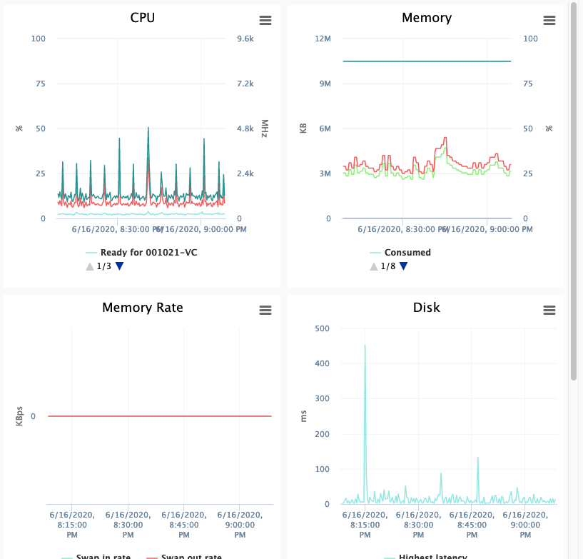

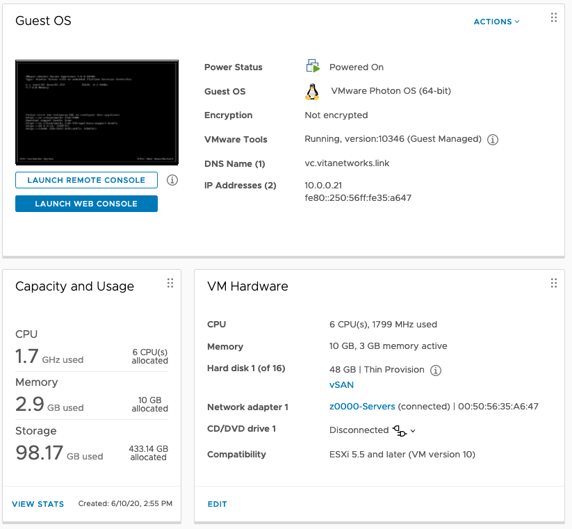

    Trying to nudge it out of it I opened vCSA's virtual console and restarted it with the F12 key. It was responsive and rebooted just fine. I'm still able to access vCSA but not Management. It's going on for almost 2 days now.
    It seems it's just a softlock:

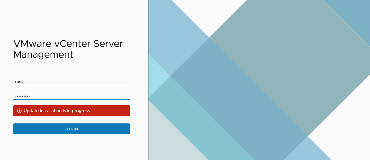

    Posted Dec 25, 2020 07:03 AM
    Do you fix it?
    I meet the same problem. Just I can login and always  stay at Update installation is in progress 0%.
  • 6.  RE: How do I cancel vCenter update -- Management inaccessible for 2 days
    Posted Dec 25, 2020 07:19 AM
    aHa, I fix it.
    This may help u.
    Accessing the VAMI returns error "Update installation in progress" after recovering from a failed update (67179)
    https://kb.vmware.com/s/article/67179?lang=en_us
    In order to resolve the issue perform the following:
    1. Login to the appliance using ssh
    2. Take a backup copy for the file "/etc/applmgmt/appliance/software_update_state.conf" to a different location
    3. Stop the applmgmt service by running command: service-control --stop applmgmt
    4. Remove the "software_update_state.conf"
    5. Start the applmgmt service using command: service-control --start applmgmt
    6. Login to the VAMI to validate the access
