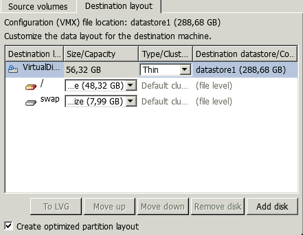

  • 11.  RE: How can I shrink the hard drive size of my guest? (Ubuntu server)
    Posted Nov 03, 2013 09:55 PM
    Yes I definitely used thin provisioning accept I specified a reduced destination disk size of 200GB (source = 500GB). I'm making a second attempt to convert again now but with a minimised thin provision (48,32GB). In theory, with a thin provisioned disk it should just increase the size of the VMDK file as and when the guest requires more space, right? I will try increasing the hard drive size limit in the VM's settings after the conversion.
  • 12.  RE: How can I shrink the hard drive size of my guest? (Ubuntu server)
    Posted Nov 04, 2013 09:36 AM
    47998976 -rw------- 1 root root 223333253120 Nov 3 15:10 morrison-flat.vmdk
    The real size on disk for this file is 47,998,976 kB which equals ~46GB. The right part will always show the provisioned size since the thin files use the file system's sparse format.
    If you want use ls -lsh to show the human readable output which show this more clearly.
    André

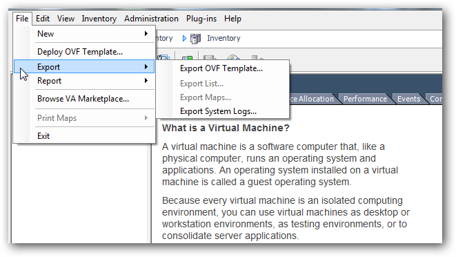

  • 13.  RE: How can I shrink the hard drive size of my guest? (Ubuntu server)
    Posted Nov 04, 2013 05:08 PM
    Ok but how does this work in terms of making backups of the vmdk file? Because as far as my ftp client is concerned I'm requesting to copy 200GB which is considerably more work that 47GB!
    I wanted to back up my guest to a USB drive. Doesn't this mean as far as my USB drive is concerned, 200GB have been used?  Would setting the conversion to minimal (47GB) before backing up be a solution?
  • 14.  RE: How can I shrink the hard drive size of my guest? (Ubuntu server)
    Posted Nov 04, 2013 05:09 PM
    You can do an export of the VM. That should take the 47 GB file.
  • 15.  RE: How can I shrink the hard drive size of my guest? (Ubuntu server)
    Posted Nov 04, 2013 05:19 PM
    How can I export the VM? I am using the free hypervisor (ESXi 5.1) and I have not found any solution apart from simply copying the directory via ftp
  • 16.  RE: How can I shrink the hard drive size of my guest? (Ubuntu server)
    Posted Nov 04, 2013 05:26 PM
    Shutdown the VM and do file -> export.
  • 17.  RE: How can I shrink the hard drive size of my guest? (Ubuntu server)
    Posted Nov 04, 2013 05:31 PM
    On the free hypervisor (vsphere 5.1) there is no such option to export the VM
  • 18.  RE: How can I shrink the hard drive size of my guest? (Ubuntu server)
    Best Answer
    Posted Nov 04, 2013 05:51 PM
    Export OVF Template is the one you want. This allows you to backup the entire VM to single or multiple files (you want single).
  • 19.  RE: How can I shrink the hard drive size of my guest? (Ubuntu server)
    Posted Nov 04, 2013 06:16 PM
    Thank you all for answering my questions!
  • 20.  RE: How can I shrink the hard drive size of my guest? (Ubuntu server)
    Posted Nov 04, 2013 05:52 PM
    The export option is the one in the screenshot, i.e. Export OVF Template.
    Another option is to use a backup application. Take a look at e.g. Trilead's VM Explorer (http://www.trilead.com/) which even works with the free Hypervisor.
    André

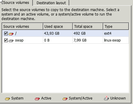

  • 21.  RE: How can I shrink the hard drive size of my guest? (Ubuntu server)
    Posted Nov 04, 2013 06:24 AM
    And what did you configure under destination layout?
