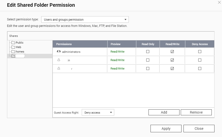

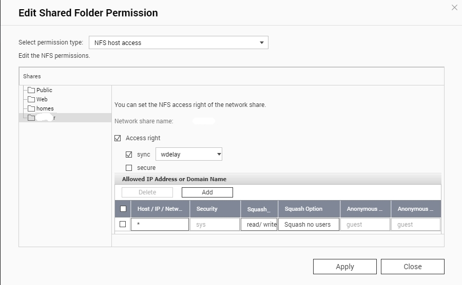

  • 11.  RE: How can I rename VM with folder in datastore?
    Posted Apr 14, 2021 06:02 AM
    Here are my settings on QNAP:
  • 12.  RE: How can I rename VM with folder in datastore?
    Posted Apr 14, 2021 06:10 AM
  • 13.  RE: How can I rename VM with folder in datastore?
    Posted Apr 14, 2021 07:34 AM
    Hi,
    Thanks for the images. Can you please be sure nfs v3 is enabled (we dont need nfs v4, so you can uncheck that)
    And can you please add IP/Netmask of your esxi host to the Allowed IP field instead of  a "*"
    Thanks,
  • 14.  RE: How can I rename VM with folder in datastore?
    Posted Apr 16, 2021 04:33 PM
    OK, I disable NFSv4, and on NFS share configuration I deleted * and added ESXI Ip address.
    Then when I'm trying to add this NFS storage I have still error "Failed to mount NFS datastore QNAP - NFS mount QNAP_IP:vcenter failed: Unable to connect to NFS server."
