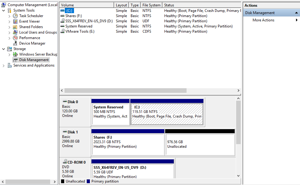

    Here is the screenshot:

    Presumably it’s the “unallocated” space on Disk 1 that you wish to no longer have allocated to the virtual disk?
  • 5.  RE: How can I release an unused partition from HDD back to datastore
    Posted Apr 08, 2020 08:35 PM
    Yes. I do not know if it possible and if it is what is the risk of harming the online partition.

    In your case you can cut off the  unused part of the flat.vmdk.
    You can use dd instead of a pair of scissors.
    I explained how to do it here: How to use dd to work with VMDKs stored on VMFS | VM-Sickbay
    Warning: this is not for the faint at heart - if you have doubts rather ask first.!!!

    You can enlarge the disk of a virtual machine on ESXi, but you cannot shrink it. This is not recommended.
    As far as I can see, it is installed on the C disk of the operating system. You can give the virtual machine a new disk, move the data in the F drive to the new disk, and then erase the F disk. This would be a smoother way.

    Okay. So now want to reclaim unallocated space from Disk1 which shows in the screenshot. This can only done via V2V using vCenter converter.
    Below are the link how using vCenter Convete to perform V2V.
    http://www.vmwarearena.com/vmware-converter-how-to-perform-p2v-and-v2v-migration/
    Note: You have need downtime for this activity to reclaim. Also, I would suggest to take backup or clone the vm before doing V2V.
    From below steps also reclaim. however , I never performed this way in production for larger disk.
    Shrink OS disk in Windows running on VMware. – Knowledge is POWER…!!!!!
