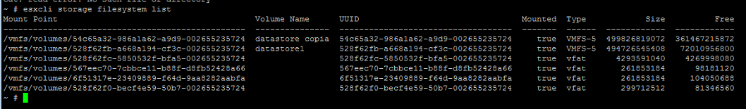

    I've check the file sytems, and there is enough space.
    I've also revised the scratchconfig location, and points to valid path, as well as the syslog global dir:

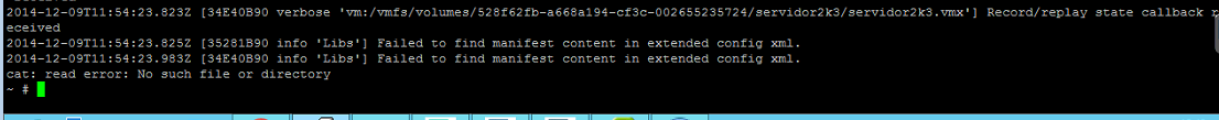

    The end of the hostd.log file is:
    How could I solve this issue? The server keeps rebooting randomly, and I can't get why is doing so.

    - In your log file (last screenshot), there is a problem with your config.xml file (the last screenshot), so check your config.xml file from /etc/vmware/hostd to see what is the problem. If you have a backup from your config.xml file, you can restore it by replacing it with the old one.

    Hello Ardaneh,
    What shuold I check on config.xml?
    BTW, ramdisk space is fine:
    I can't upgrade to newer version because the hardware is not supported, is a HP Proliant DL 180 G6 with a basic RAID controller, no hard.

    I mean check if your config.xml file is not corrupted or missing proper tags. Please check other log files to find more information.
