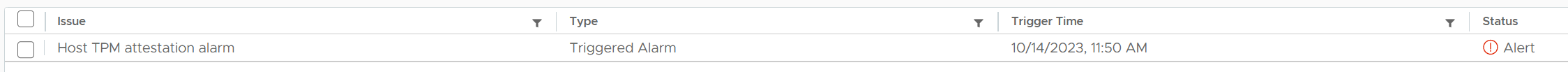

    Hi all,
    i have a fresh installed vCenter Installation what shows a triggered alarm: Host TPM attestation alarm but no details.
    Can anybody tell me where i find details what the problem is?
    Thanks

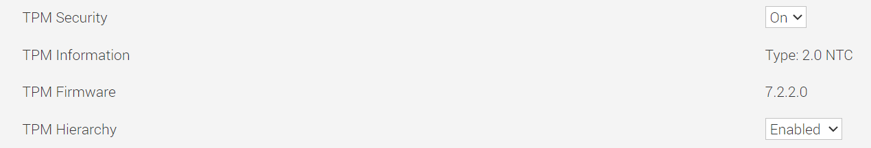

    Where i find the TXT Feature, it doesn't show up ?
    CPU AES-NI Enabled
    System Password Empty
    Confirm System Password Empty
    Setup Password Empty
    Confirm Setup Password Empty
    Password Status Unlocked
    SHA256 hash of the System password Empty
    Salt string appended to the System password prior to hash Empty
    SHA256 hash of the Setup password Empty
    Salt string appended to the Setup password prior to hash Empty
    TPM Security On
    TPM Information Type: 2.0 NTC
    TPM Firmware 7.2.2.0
    TPM Hierarchy Enabled
    TPM Advanced Settings
    AMD DRTM Off
    Power Button Enabled
    AC Power Recovery Last
    AC Power Recovery Delay Immediate
    User Defined Delay (120s to 600s) 120
    UEFI Variable Access Standard
    SMM Security Mitigation Disabled
    Secure Boot Disabled
    Secure Boot Policy Standard
    Secure Boot Mode Deployed Mode
    Authorize Device Firmware Disabled
    UEFI CA Certificate Scope Device Firmware and OS

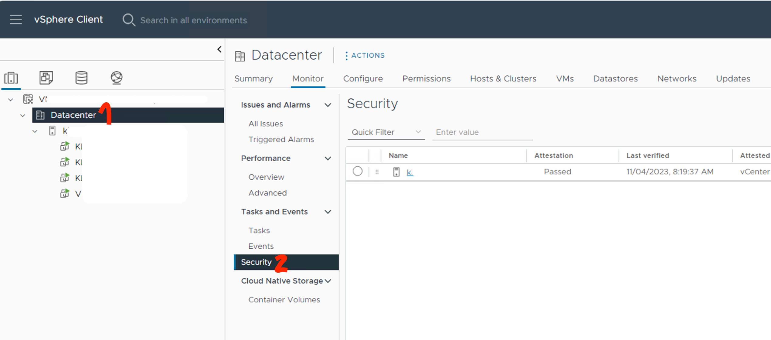

  • 8.  RE: Host TPM attestation alarm | Fresh Installed vCenter 8
    Posted Nov 07, 2023 11:16 AM
    It is solved. You've click to Datacenter -> Security at this Point you've the exact problem vcenter is expecting.
    in that case, Secure Boot - Disabled was the problem.
