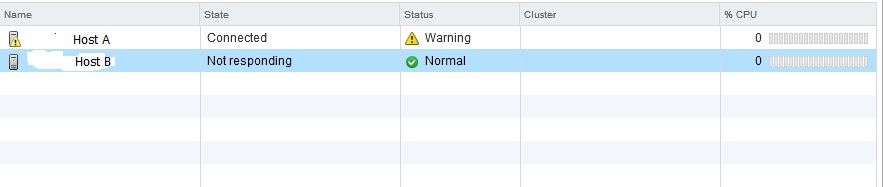

    My Host B state become Not responding. but I still able to remote access by putty. How to solve this?

    But I can ping and access to the host? I restrat also same..

    do you have a firewall in place between that host and your vCenter?
    have you tried to restart the management agents on the Host?

    Nope. I disable all my firewall. I restart also same..

    Are you hosts the same,  ie both DB380's
    do you have the same NIC cards in both?

    My hostname is not the same.
    I use the built in NIC card HP DL380 G5

    Are you able to connect to the host using vsphere client ?
    If you are  not able to, then it clearly states that the hostd agent of the server is not responding. That is the very reason it is seen as not responding in vcenter.
    You can try browsing the datastores from ssh if it gets stuck at the prompt then that is the reason for the hang of hostd agent.
    If the host is seeing any storage related issue or any hangs in the network then the host would get into a not responding state.
    you can review the vmkernel logs then it should tell us the reason for the hostd hang.

    I able to connected. But this one just show in my web client.
    I using putty to connect. I can access to ESXi host.

    This is often an issue with an incorrect or not working name resolution (DNS). Please verify the host can resolve the vCenter Server's short and FQDN name and vice versa.

    The DNS I use on host A and host B is the same. So nothing wrong in Host A.  I don't think is a DNS problem.
    For my environment
    I use DL380 G4 as the Domain Controller and DNS Server.
    DL 380 G5 as ESXi01
    DL 380 G6 as ESXi02
    A Laptop HP Pavillion (Windows Server 2008 R2) - 8GB RAM and Intsall vCenter on it..
    Are you able to access the Host A using name from your vCenter server

    Well, can you confirm it's not a DNS issue? To rule this out as a  possible issue, please double check the settings and try to ping the host from your vCenter Server and vice versa using the name and FQDN.
