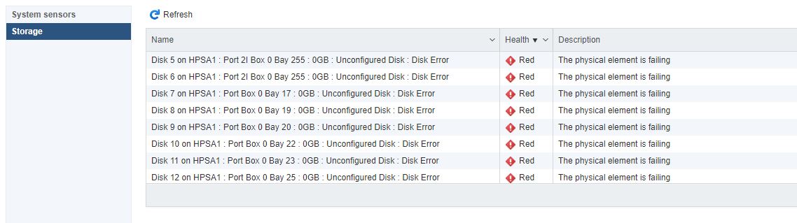

    I am running a single ESX Host 7.0 U1 (HP Microserver Gen10 plus) with HPE E208i-p SR on 4x 2TB SSDs (single lun).
    I am getting many hardware errors with unconfigured disks, system runs normal:
    I also tried searching for any help, but all infomation is based on older ESX versions...
    Does someone have a solution for this ?

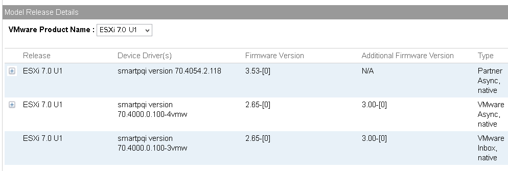

    Hi, no new firmware available for the controller, because I am already using V 3.53.
    Maybe I try using the drivers from ESX 7.0U2a for "smartpqi", this is newer than my actual one:
    old: 70.4000.0.100-4vmw.701.0.25.17325551
    new: 70.4000.0.100-6vmw.702.0.0.17867351
    I don't know if this is a solution...

    According to the VMware compatibility matrix (online) for the HPE Smart Array E208i-p SR Gen10 with Firmware 3.53,
    VMware ESXi 7.0 smartpqi 70.4054.2.118 driver is required.
    https://www.vmware.com/resources/compatibility/detail.php?deviceCategory=io&productid=43646
    Download driver from https://my.vmware.com/en/web/vmware/downloads/details?downloadGroup=DT-ESXI70-MICROSEMI-SMARTPQI-7040542118&productId=974
    How to download and install async drivers in VMware ESXi (2005205)
    https://kb.vmware.com/s/article/2005205

    To resolve this issue, remove the "smx-providers"
    For VMware ESXi 6.5 / 6.7
    esxcli software vib remove -n smx-provider
    For VMware ESXi 7.0
    esxcli software component remove -n smxProvider

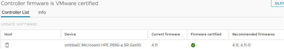

    VSAN Skyline Health for ESXi 7u3 recommends Firmware 4.11. If you want use 7U3 you couldn't downgrade to 3.00.
    I ask myself, is it better to remove the smx-provider and not see anything like controller battery, connected disk, logical disk.....or ignore the error message of non-existent disk?
    what do you think?

    We got the same problem with a
    • ProLiant DL20 Gen10
    with a VMware ESXi 6.7.0 U3 HPE Custom Image installed
    after Update with Gen10 Service Pack for ProLiant 2021.04.0 (19 Apr 2021)  the HPE Smart Array P408i-a SR Gen10 firmware go up to 3.53
    and than the VM Hardware -> Storage went crazy
    i used the Workaround https://kb.vmware.com/s/article/74607  to got time because the errors will fill up the event log
    "You can avoid this issue by disabling the WBEM services. To disable the WBEM services on the ESXi host, run this command:
    esxcli system wbem set --enable false "
    I used the https://support.hpe.com/hpesc/public/swd/detail?swItemId=MTX_1b05b3627f244efebc5553b7f4 3.00 Driver File from HPE for downgrade
    • Login as root. (You must be root in order to apply the update.)
    • Place the Smart Component zip file in a temporary directory.
    • Unzip the file CPXXXXXX.zip
    • Ensure that CPXXXXXX.vmexe is executable by using the command:
                 chmod +x CPXXXXXX.vmexe
    • From the same directory, execute the Smart Component. For example: ./CPXXXXXX.vmexe  --downgrade
    • Follow the directions given by the Smart Component.
    and the problem with the "Sensor -1 type, Description Disk XX " errors are gone
    we got one more problem with a memory sensor
    after clearing the system sensors event log this problem was also gone
    I hope HPE will fix that in a newer firmeware of the raidcontroller
    i added a screenshot of the downgrad on the esxi server

    Have anyone tryd Smart Array Controller Firmware 3.53 with the new drivers
    https://support.hpe.com/hpesc/public/swd/detail?swItemId=MTX_c9d0851fba6d4775b233f93b7c
    Type:Driver - Storage Controller
    Version:2021.04.01(B) (4 May 2021)
    Operating System(s):VMware vSphere 6.7
    or
    https://support.hpe.com/hpesc/public/swd/detail?swItemId=MTX_ff8a3aa9a1de4b78ab3ee5d19c
    Operating System(s):VMware ESXi 7.0
    if it maybe fixes the problem ?

    Hi Michael,
    I am running this same version (70.4054.2.118-1OEM.700.1.0.15843807), and the problem is still present. Waiting for HPE to deliver a newer version.
    Kind regards,
    Jaap
