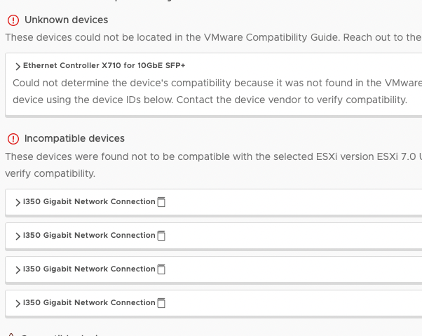

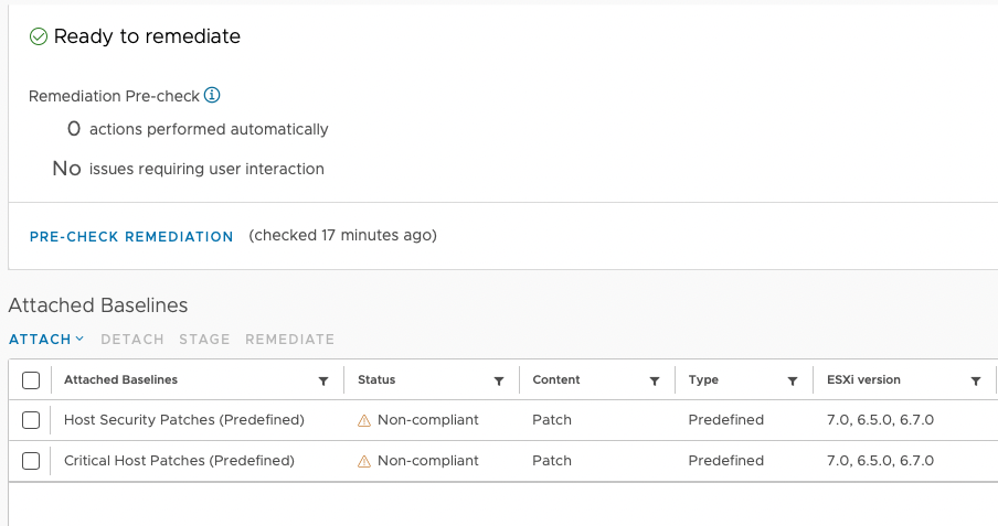

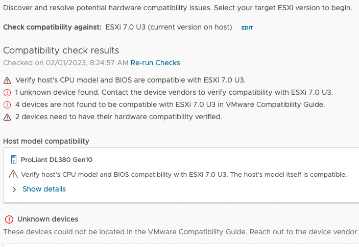

    Hi,
    I'm running v7.0U3 with two esxi HPE ProLiant hosts, each running a handful (5-6) of VMs. I'm looking to remediate to bring one of my hosts up to be in compliance. I'm still not sure how the build #s relate to U3C,D, E, I, SI, etc but that may be irrelevant at this point.
    I ran the hardware compatibility test and one says all the NICs are incompatible with 7.0U3, which they can't be since they work. I'm just worried that installing the baseline WILL break them so I'm wondering if there's a page of how to read these reports and what I should update (if anything) before installing this.
    Thanks,
    Jeff

  • 4.  RE: Hardware Compatibility says "Incompatible" yet it works
    Posted Feb 02, 2023 03:22 PM
    I suppose the question then is: would applying a minor esxi update cause an otherwise (even unofficially) working device to stop working.
    My 2 cents says no; it's probably ok. But I would feel much better if anyone running a DL380 Gen10 with an i350 NIC and the latest release of esxi chimed in.
    Also, it looks like they just made ESXi70U3j-21053776 available a couple days ago, so there's an even newer release out.

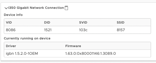

    If you do a filter on the VMware Compatibility Guide as follows:
    What are you looking for: Set to IO devices.
    On the right hand side set VID, DID, SVID and Max SSID to the values shown in your screen shot for your device.
    Update and View Results and you'll be left with two entries.
    One posted by HP and one by Intel Corp.
    The HP one doesn't look like it has been updated since vSphere 6.7.
    Intel's entry says the "HP Ethernet 1Gb 4-port 366T adapter" is compatible with ESXi release from 6.5 through to 8.0.
    Skyline Health uses the same data, and probably uses HP's entry rather than Intel's for determining the result.

    OK! Getting closer:
    From my console, I ran
    esxcli network nic get -n vmnic5
    and got
       Driver Info:
             Bus Info: 0000:11:00:3
             Driver: igbn
             Firmware Version: 1.63.0:0x80001146:1.3089.0
             Version: 1.5.2.0
    So I'm apparently running driver 1.5.2. It's not listed on either matrix. Do drivers get updated as part of remediation, or should I install the latest driver (1.10.2.0) manually beforehand? Originally, this was installed using a custom image that had all the drivers for the HP  equipment. This was my first ESXI server and when I first did it I thought "how nice, vmware and HPE are in sync with each other to make installers available." Maybe that was just for the initial install and updates are a bit more messy.
